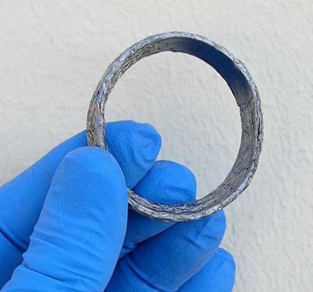

No that is the flange retaining clip. The gasket is in the head... like this. Tapered steel mesh.Yes, I still have the stock ignition. Are the exhaust gaskets pretty much standard. I had pipes off to do the clutch cable. Is the gasket just a thin metal gasket that kinda resembles a split washer? Im going to the Harley Dealer tomorrow to see if they have some other stuff I'm looking for. I'll get them too.

Thanks. I'll do that today and get back to you.No that is the flange retaining clip. The gasket is in the head... like this. Tapered steel mesh.
