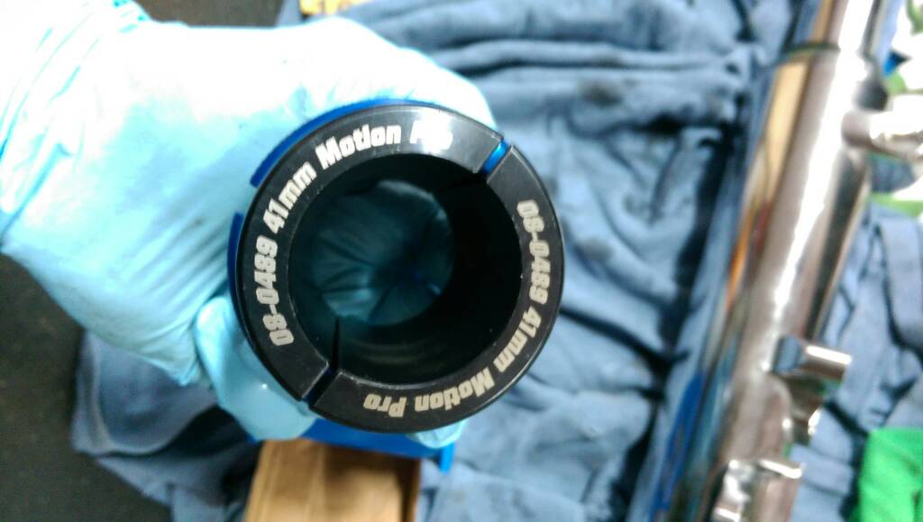

That's a good question. I would rather not take my front forks off either....especially if I am drinking! I bet it can be done and I will try it. The less I take apart the better.Eric, or anybody, but Eric just did his so here's the question. Instead of taking the forks off the bike can you put it up on a stand and remove the lower sections to replace the seals and bearings?
X2....Received mine a week or two ago and it is sitting next to my WSW rebuild kit. I am trying to finish another project first. And, I've got to perform maintenance on the boat so it's ready to go...so it's the third project in line.You ordered before me and I got mine last week, your not a Prime member are you? Can't beat the free 2 day shipping!
The only problem that I can see would be if you can't jack it up high enough to get the lower portion off before you hit the ground, but I have a pit and I could position the bike so the forks would be over the pit and height wouldn't be an issue. I have never done this yet, but I'm with ya Nuke, I would rather not pull them completely offThat's a good question. I would rather not take my front forks off either....especially if I am drinking! I bet it can be done and I will try it. The less I take apart the better.
Great. I can lift the front end as high as required. I can use an engine lift, ceiling hoist, or adjustable I beam if needed. I'm thinking the engine lift will work since I used it to lift a new engine over the transom when swapping out the engine 10 years ago.The only problem that I can see would be if you can't jack it up high enough to get the lower portion off before you hit the ground, but I have a pit and I sould position the bike so the forks would be over the pit and height wouldn't be an issue. I have never done this yet, but I'm with ya Nuke, I would rather not pull them completely off
Well interesting question I don't see why you HAVE to remove the forks obviously need the room. However if you don't pull the fork tube off you can't clean the spring and damper since that would come out the top of the tube. Truth be told I didn't pull mine out either since I didn't loosen the fork tube cap and didn't want to install just to loosen them. All the gunk sits at the bottom of the fork leg anyways.Eric, or anybody, but Eric just did his so here's the question. Instead of taking the forks off the bike can you put it up on a stand and remove the lower sections to replace the seals and bearings?
You are not selling?You know Eric, I'm about due for a fork job. You could be my new best friendI don't have that cool tool.
Just seemed to take a lot more effort. Try the tool Curtis I promise 1/2 the effort they in like butterThats funny because thats the only way I've been doing it for years and dont' have any issues.
I have a 3 foot piece of pipe on the coupling. Couple of slams with it and their in.
HI Eric, I am at the stage to rebuild my front forks on my 06 Mastiff. Could you give me the URL (link) to WSW for all the parts that I might need. Thanks a great write up on the build. Photos are worth keeping for reference. Thanks for taking the time to share your build.That seal kit won't work you are missing the copper bushings in my last picture. You want to replace that bushing.
Look up 41mm Fork Bushing Kit and you will see what I mean. Those kits are about $30 then you still need to buy the seals which is another $10 and also buy fork oil.
For the price WSW sells the whole kit plus the 10oz of oil all measured out for like $60. It's worth the price and don't have to fart around measuring oil then you have 12 oz left you won't use for years.
