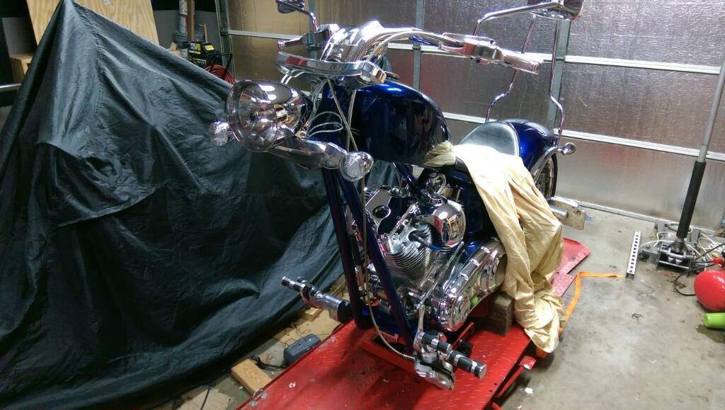

Eric, or anybody, but Eric just did his so here's the question. Instead of taking the forks off the bike can you put it up on a stand and remove the lower sections to replace the seals and bearings?
That's a good question. I would rather not take my front forks off either....especially if I am drinking! I bet it can be done and I will try it. The less I take apart the better.

The only problem that I can see would be if you can't jack it up high enough to get the lower portion off before you hit the ground, but I have a pit and I could position the bike so the forks would be over the pit and height wouldn't be an issue. I have never done this yet, but I'm with ya Nuke, I would rather not pull them completely off

Great. I can lift the front end as high as required. I can use an engine lift, ceiling hoist, or adjustable I beam if needed. I'm thinking the engine lift will work since I used it to lift a new engine over the transom when swapping out the engine 10 years ago.

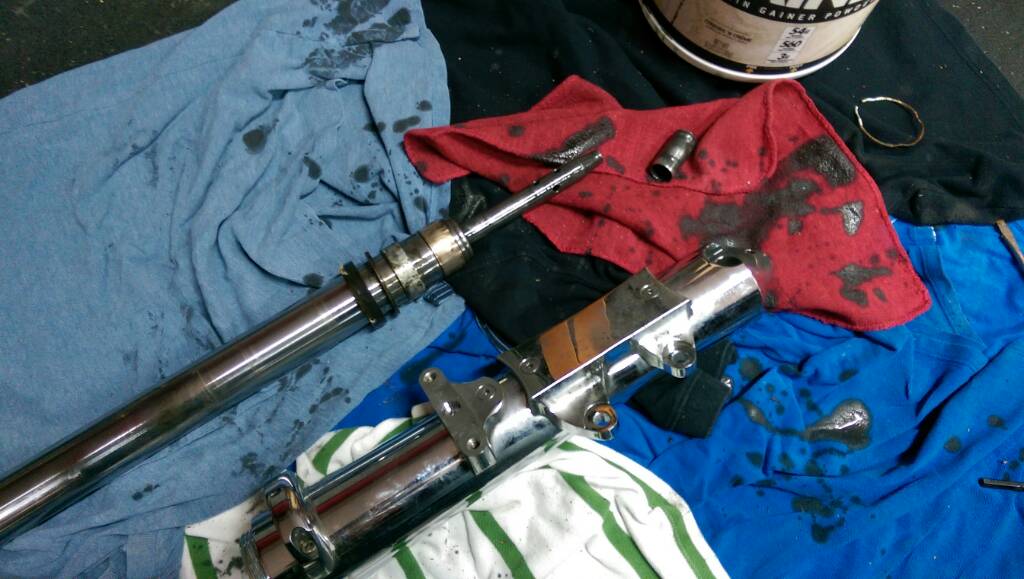

Well interesting question I don't see why you HAVE to remove the forks obviously need the room. However if you don't pull the fork tube off you can't clean the spring and damper since that would come out the top of the tube. Truth be told I didn't pull mine out either since I didn't loosen the fork tube cap and didn't want to install just to loosen them. All the gunk sits at the bottom of the fork leg anyways.

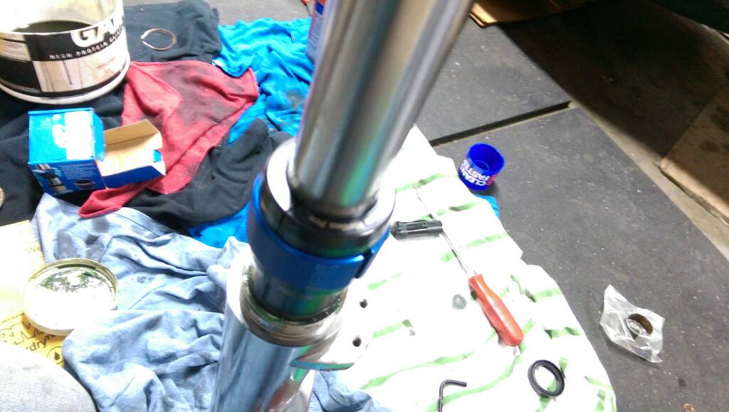

With that said it's not any more work to remove the leg just the 4 pinch bolts on the trees. You already have to remove the wheel, fender, brace, and brake caliper anyways. I feel like it would be a pain not pulling them off and trying to drive the seal while holding the lower leg with your other hand. I just sat mine on the rubber floor to hold it together while I drove the seal.

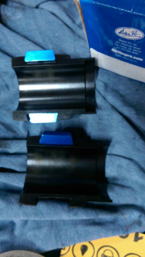

You know Eric, I'm about due for a fork job. You could be my new best friend:oldlaugh: I don't have that cool tool.
You are not selling?
I didn't have the cool tool a few years ago and used PVC ...tool was 10x easier to drive in the seal and Jon and I were hammering away on the PVC it took two people one to hold it and one to hammer and it was just stupid.

Just seemed to take a lot more effort. Try the tool Curtis I promise 1/2 the effort they in like butter

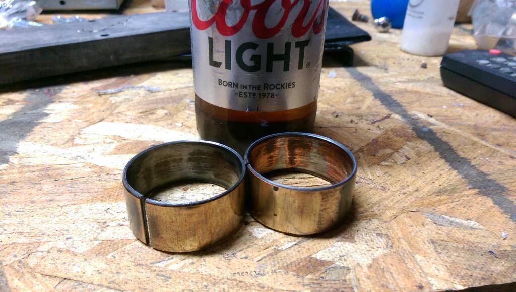

That seal kit won't work you are missing the copper bushings in my last picture. You want to replace that bushing.
Look up 41mm Fork Bushing Kit and you will see what I mean. Those kits are about $30 then you still need to buy the seals which is another $10 and also buy fork oil.
For the price WSW sells the whole kit plus the 10oz of oil all measured out for like $60. It's worth the price and don't have to fart around measuring oil then you have 12 oz left you won't use for years.
