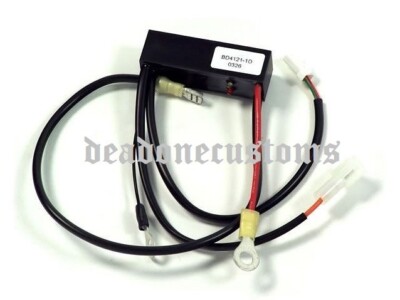

03 Chopper,
I just had this (starter relay) take a dump on me .. The previous owner must have had a issue with it too because the starter trigger wire was already ready reouted (something I've never traced out) the relay out going big green wire was simply cut and is not connected to anything. But I lost all power .. it must be something like a double relay ? One for the starter selonoid and one for the "run" curcuit. Because the key switch wires come out of it too. With key on it triggers the run curcuit and powers up everything - ie: orange out going wire to the EHC. In my case the small red wire which is power supply to the key simply wasn't getting any power. I put a common 12v relay in to solve it . I have 03 wiring diagrams and neighter that or the BD relay has any diagram(s) about the inner workings of said relay.

This is a picture of the bad relay i took out of my 03 chopper.
I cut the small plug off for the 3 small wires grouped together. (Orange, red, green)
Note the phone key.. what I used to insert into the plug and test the above 3 curcuits.
So relay all hooked up other then the small 3 wire plug.
Using a 12v test light.
1st the small red wire does it test for +12v power . It should show power when the relay is connected to the battery. Your testing the plug end thats wired to the relay.
No power that's a problem.. This wire should show power at all times key on or off.
No don't take fender off .
Chong
U-238
If it tests bad .. plug the jump key into the Orange wire on that plug..
Use jumper wire and connect to 12v+.
Things may light up now.. as if key is on.
Note your start button will not work since that little green wire isn't hooked up.
If things don't light up you can jump 12v power to plug 4 pin 13.. on the EHC .
You can identify plug 4 pin 13 by looking at the #201 diagram Mikeinjersey attached above. This should light things up.. power up the EHC.
Further explanation. Plug 4 pin 13 is the same wire coming out of this relay. On mine it's the single orange(mine has a white stripe) wire that comes out of this relay. Follow that wire to the ECU , that's where you want to jump +12v to . There could be a inline single wire plug on that wire. I have revA and revB schematics.
Rev B shows the plug Rev A does not. If you have that inline single plug you simply unplug there and jump +12v to the end thats attached to the ECU.
For the record my bikes previous owner has replaced (spliced) in a new wire here. So mine doesn't have the inline plug.
The above tests cover the ignition side of the relay. There is a second function where it engages the starter.
