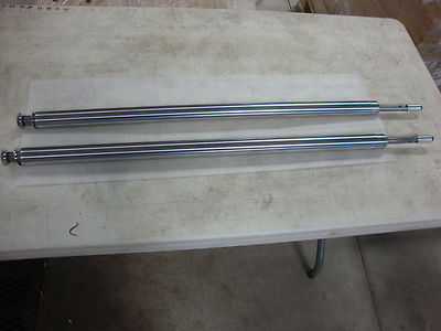

You can buy a full tube set for with springs from Donna for $200 ,
