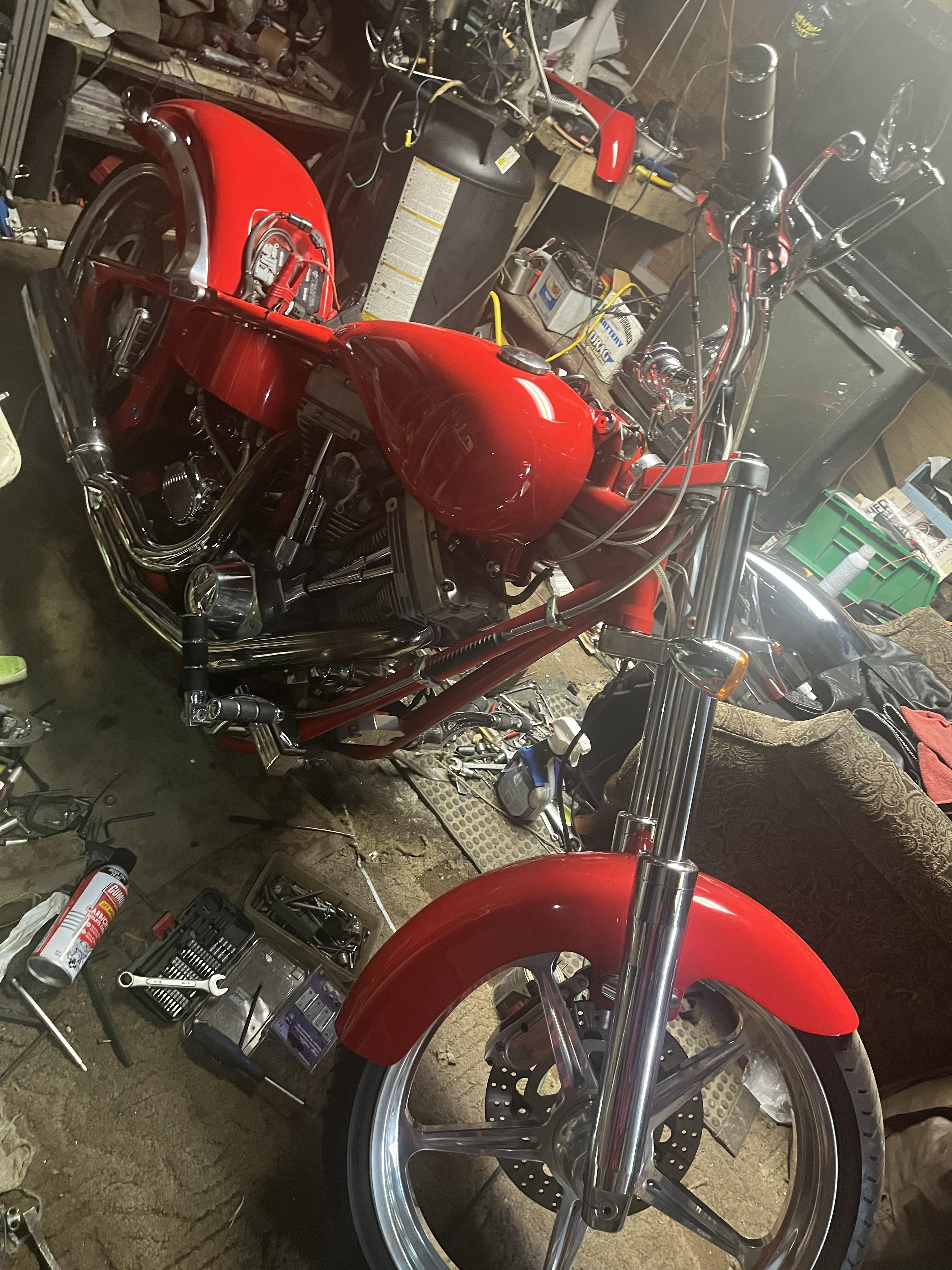

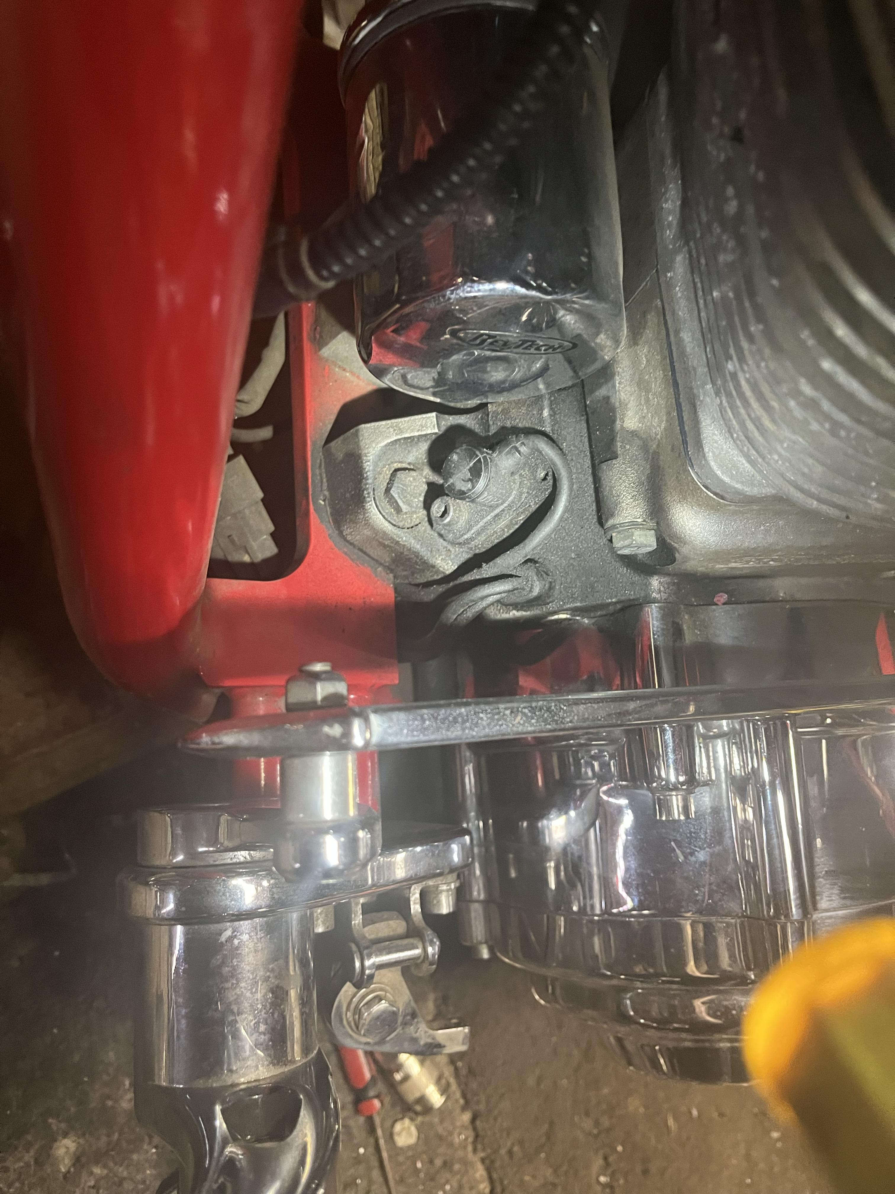

I don't think they made a 107 in 2011 or 2012. Sounds like a 117 motor. Have you changed the crank sensor? Do you have spark at the plugs?
Ribert R
It’s still not alive. But close
That is almost exactly what it looks like but red, I’ll push it out after I eat and get photos for you
Ribert R
I have not changed the crank sensor but I seen it had one while ago. I’ll eat and shoot you two some pictures
Ribert R
That is why I came here so I can learn from yall. And I do appreciate the help ALOT. And I did not know they went to a crank sensor. I’m learning as I go. All my bikes have been 04 and older, H-D 1st big dog
Mickmorris
Well Known Member

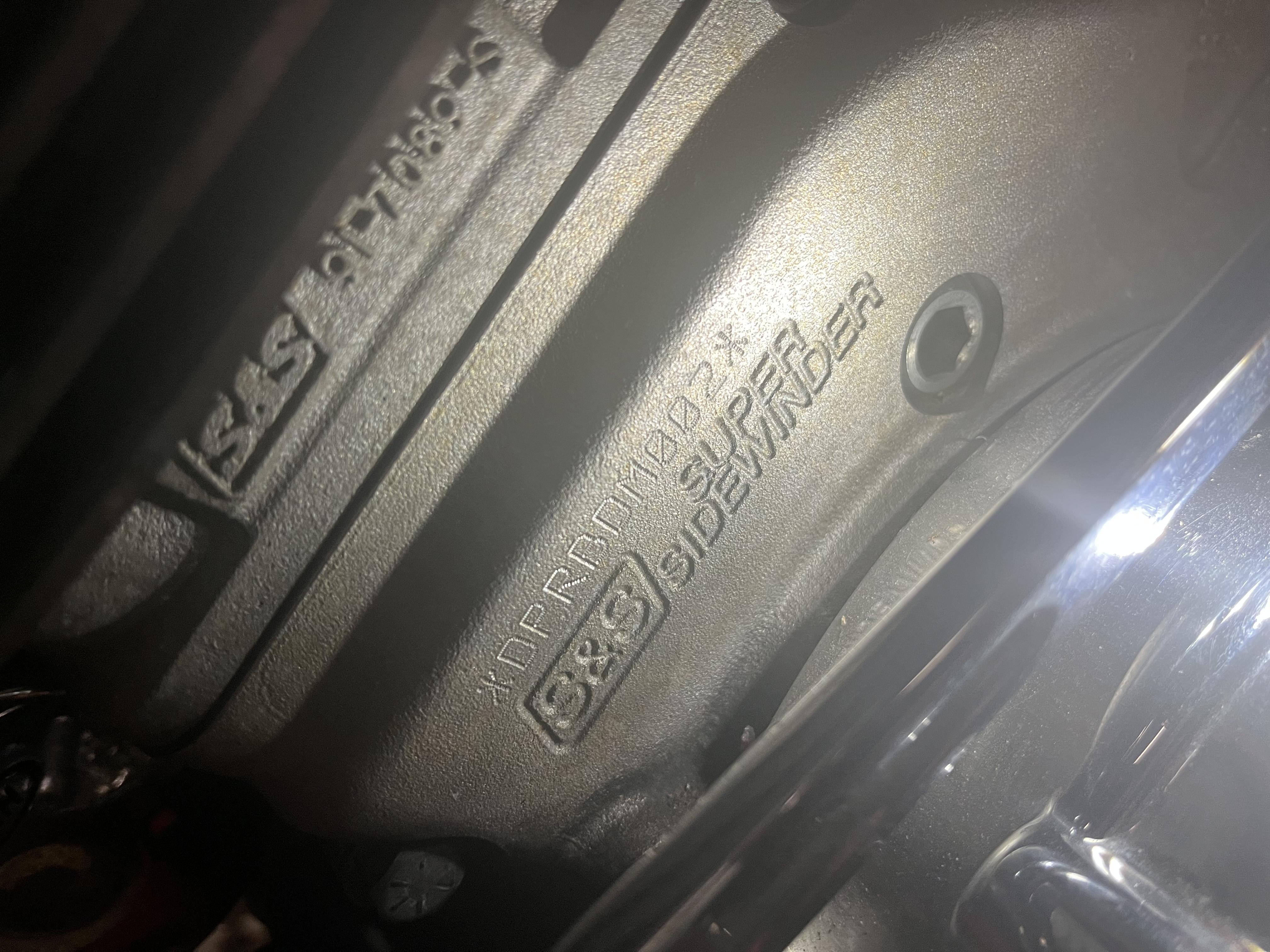

Here’s some useful information about your engine. He must have added the EFI. This looks like it came with a super g. After looking at your pictures you posted ( nice bike btw) that definitely is a’03 frame & front end from all visible appearance.IMG_9732.pngIMG_9733.png

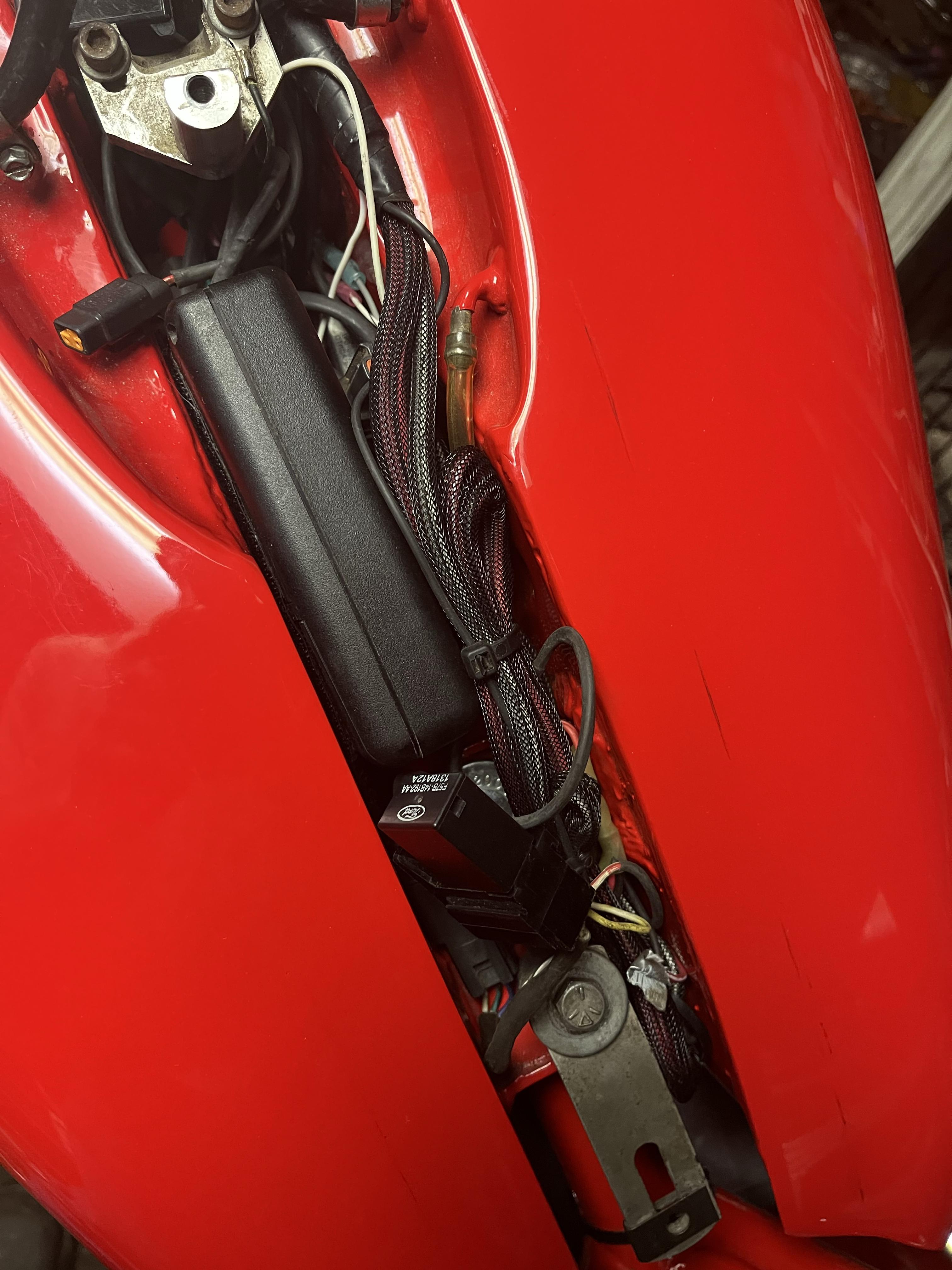

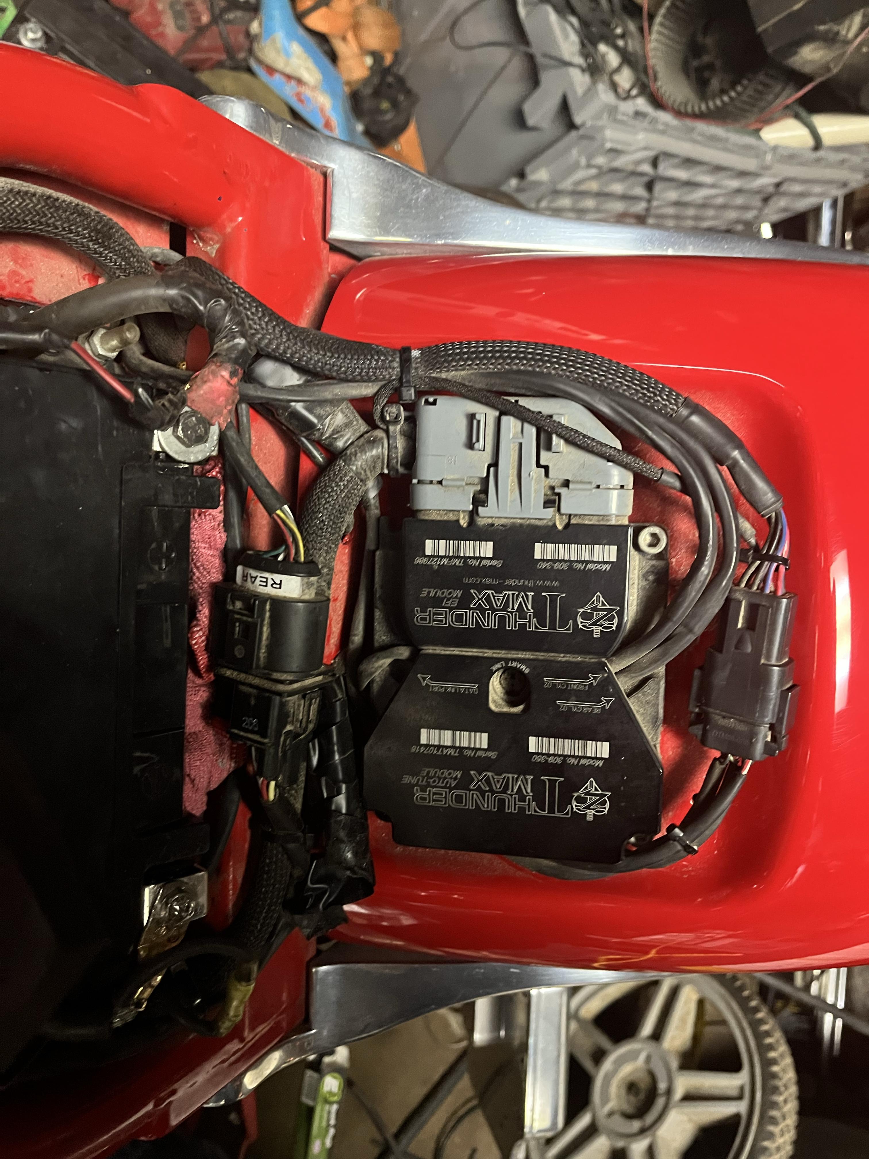

The long black unit between your tanks is?? I’m guessing your ECM? This is the location of my thunderheart ECM on my 2000
Ribert R

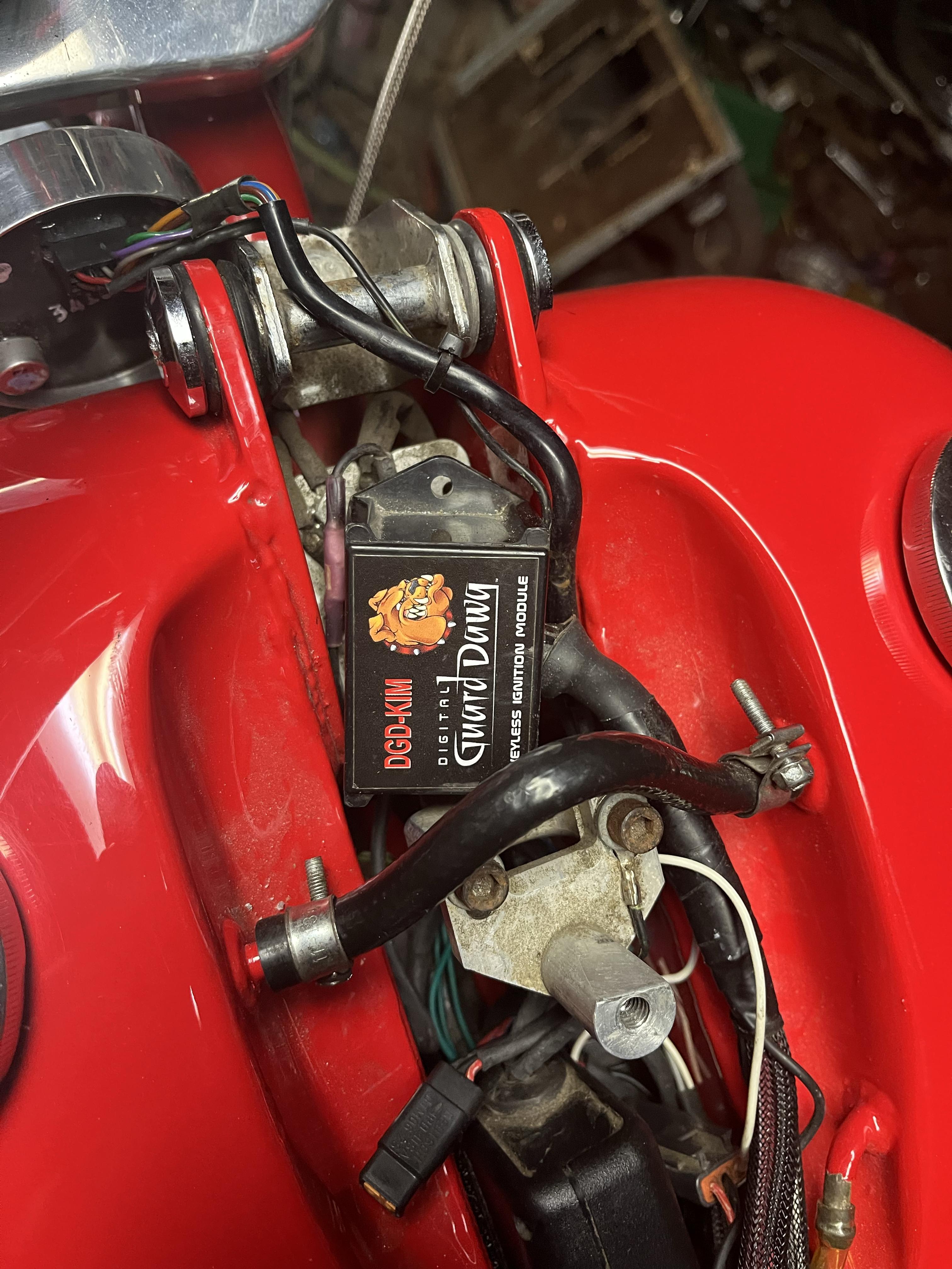

That is what is stopping my fire from the plugs right.? I can jump over that to the other side what is that up closer to my handlebars. That little square box
Mickmorris
Well Known Member

It was confusing , listening to him. He didn’t build the bike but did add the security and key fob. And that plug and play is what it is exactly. I’m back to having power to the coil but none to the plugs. I did the test s to the coil. From middle terminal to either side was 3.5 to 3.6, then I tested the outside ones and it came to over 7.2. Then I tested the positive to the plug side. It was 11. 23 on one side and 11.33 on the other, that is all in range. I am not real sure but can I jump over the exam and hook a wire from one side of it , over to the dead side and see if it will then fire , or will that hurt the bike. I am very seriously thinking about getting rid of all of it , and putting a nose cone set upon it. I just want to ride it. I also have that sportster I’m building. It has three or more ways I can build it 883 punched to a 1000. But I need this one up and running. I almost thought about giving it towho ever can get this running right . It’s going to be nice when it’s all finished
