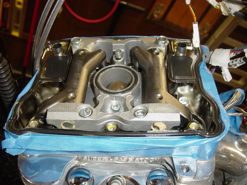

Pulled the rocker box tops on mine today...
(don't mind the tape, all taped up for other work)
Found what I thought I would find red striped 640 springs. :2thumbs:
Gee everything looks so nice and new.. :whoop:
So that is what the holes in the collars are for... cool... didn't know that!
Vegas
Definitely would help with oiling but the main reason is weight reduction of the retainer. Gas you had the dealer put in your .640 springs. I take it you were just making sure they did so.
Yeah they were put in when I got it... so yes just checking and trying to also post pics of the said red stripe.
