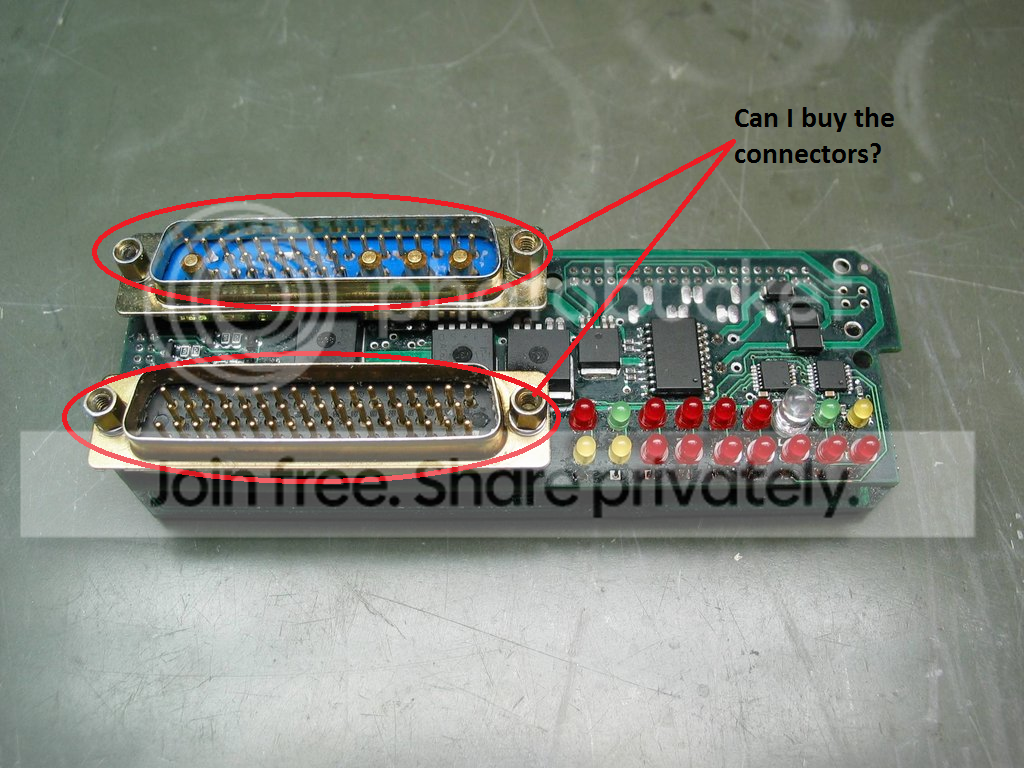

Nope I'm looking for the Male Connectors. I'm just curious to try something.They are made and sold by Positronic.
They are a complex conector system because of the different pin sizes, connector pin tail length and wire gauge crimp capacity.
Those connectors in the photo are Male connectors...is that what you want? or the BDM harness ends which are Female.
I thought the thinking was done by wire plus.Nope I'm looking for the Male Connectors. I'm just curious to try something.
I know 05+ they went to a 2 connector Harness, which is the one I am most interested in obtaining. I assume the FI models may have an extra pin or two.
Ill look around for Positronic stuff see what I can't dig up thanks! I might just spin my wheels but just trying to think some things through on all of this.
I'm not sure whether this will help but here's the Postitronic part numbers I came up with:Ill look around for Positronic stuff see what I can't dig up thanks!
Wire plus did some thinking, I would say it's fully inclusive. They still make you cut and splice 50+ 22 AWG wires. What if there was a plug and play harness available?I thought the thinking was done by wire plus.

Power harness = CBD36W4M3600T20
Backbone harness = MD50M3200T20-526.5
I emailed them a couple of years ago to ask how I could get these connectors and never heard back... :down:

DB,Plug and play would definitely have been my first choice if available. Hope you come up with something. After installing the wire plus i ordered a set of spare harnesses.
BDMPP has the PDM harness that plugs directly into all connections. Very simple install. Even I didn't F it up.
You can get both male and female connectors for 50 and 36 pin combo-D from Digikey.com.DB,
Last night I looked through their product catalogs. It appears BDM must have got a custom harness made because their standard 50 pin connectors are shorter but wider than the BDM :bang:
Looks like it will be difficult to get your hands on these without having them make them up, I'm sure they don't do small orders.
