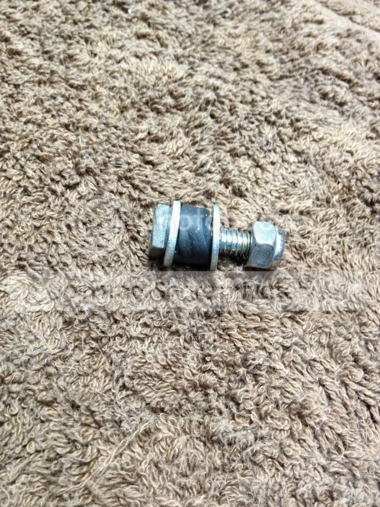

I think another good way to prevent this and I am getting ready to redo my left side is put a bugger washer under the nut and use two (one on each side) rubber washers in order to allow the cover some play or give. This will take alot of strain off of that spot and spread it out more then just tightening the crap out of that bolt straight away on the plastic.
Just my .02!
Just my .02!
Let us know how it works out for you.... I didn´t manage to take the f,,,g bolts off yet... almost broke one of the covers... I will try again when I go back home next R&R!

Yes Franco,
I use hardware bolts, lock nuts, washers and just a rubber hose cut to length to fit the ear hole and bolt. I have done this for various items in the last ten years. You cannot even tell there is a rubber hose insert when cut to fit the hole. It prevents you from crushing your pieces together and takes up some vibration transmitted from the frame to the battery cover tabs.
