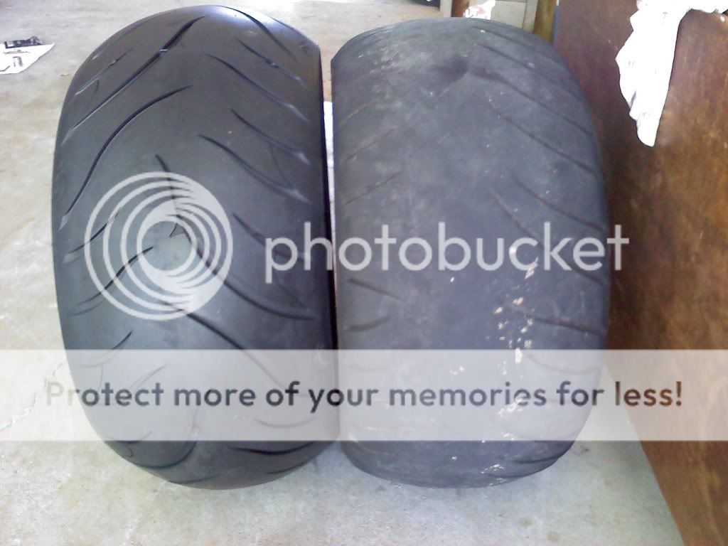

i figured after 9300 miles i should put a new tire on my k9. most of the wear has been to left side..i guess if i could gangsta lean to the right i could get another few out of it. i priced getting just tire installed on rim off the bike and only a couple shops said they could do it..at $100!

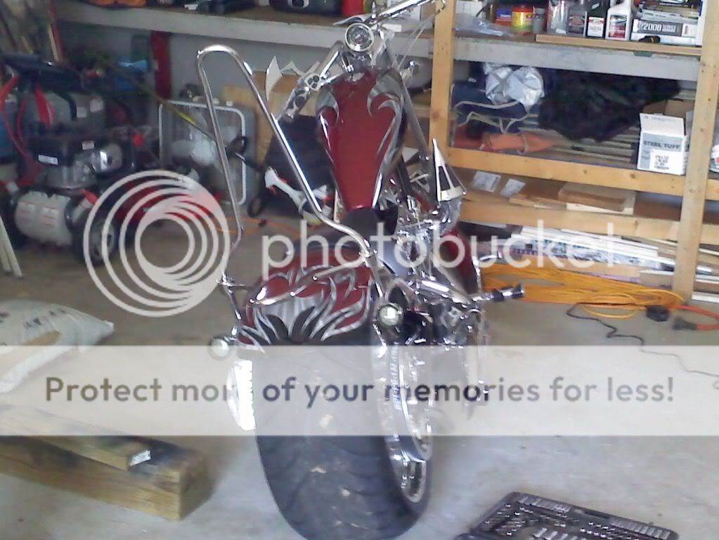

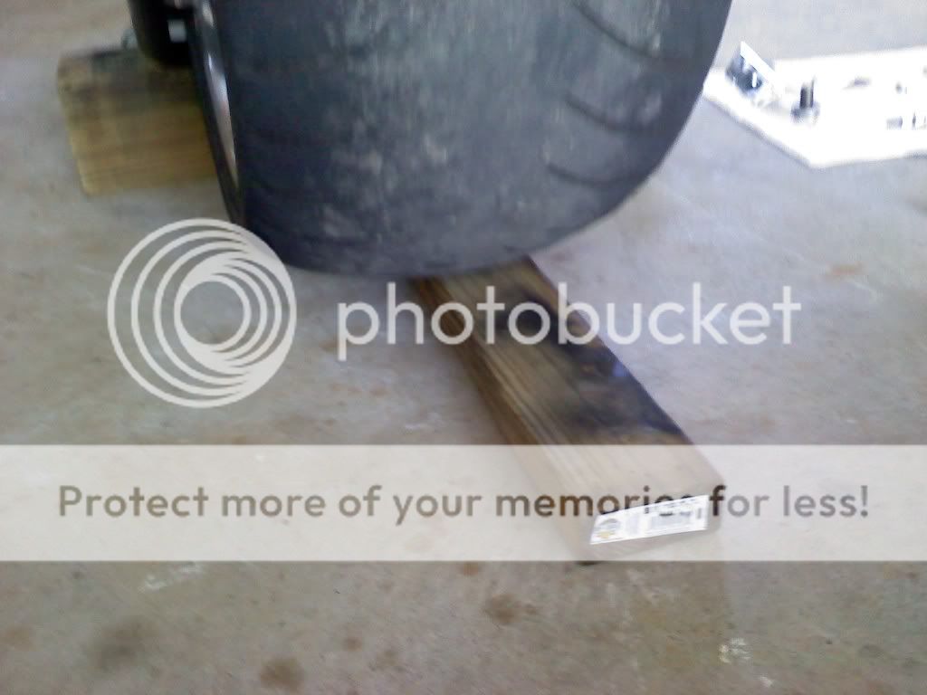

i dont have a lift so i used my jack to lift bike up then sat frame down on 6x6.. perfect height off floor and use a 2x4 under tire to support it when pullin axle.

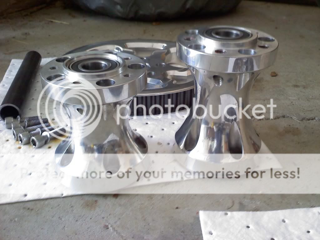

i thought i would post a few pics to help out with the other how to's on the job. with the 300 tire there are two spacers on the rotor side of hub and one larger on the pulley side. each side has a spacer with a small lip on it.. be sure to replace it with the lip towards the tire and against the bearing that is in hub.

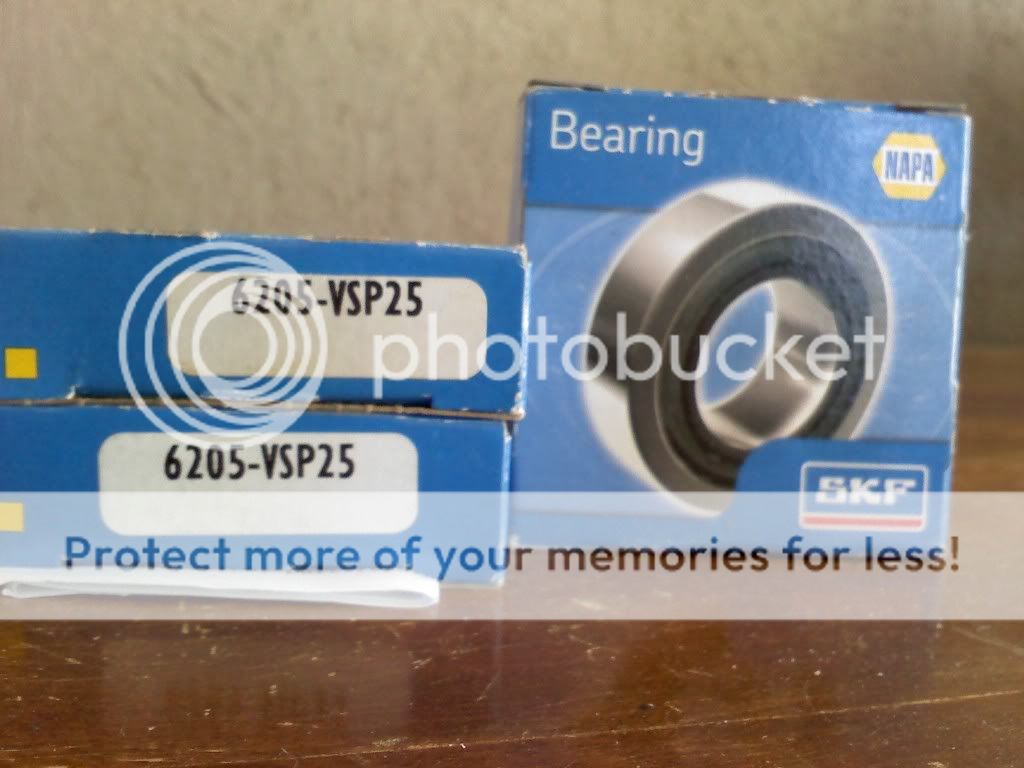

the longer hub is on the drive side(pulley) and contains 2 bearings, the rotor side has one. i replaced the bearings also and had them pressed in which was only $20 done by a professional
the bearings were also about $20 each.

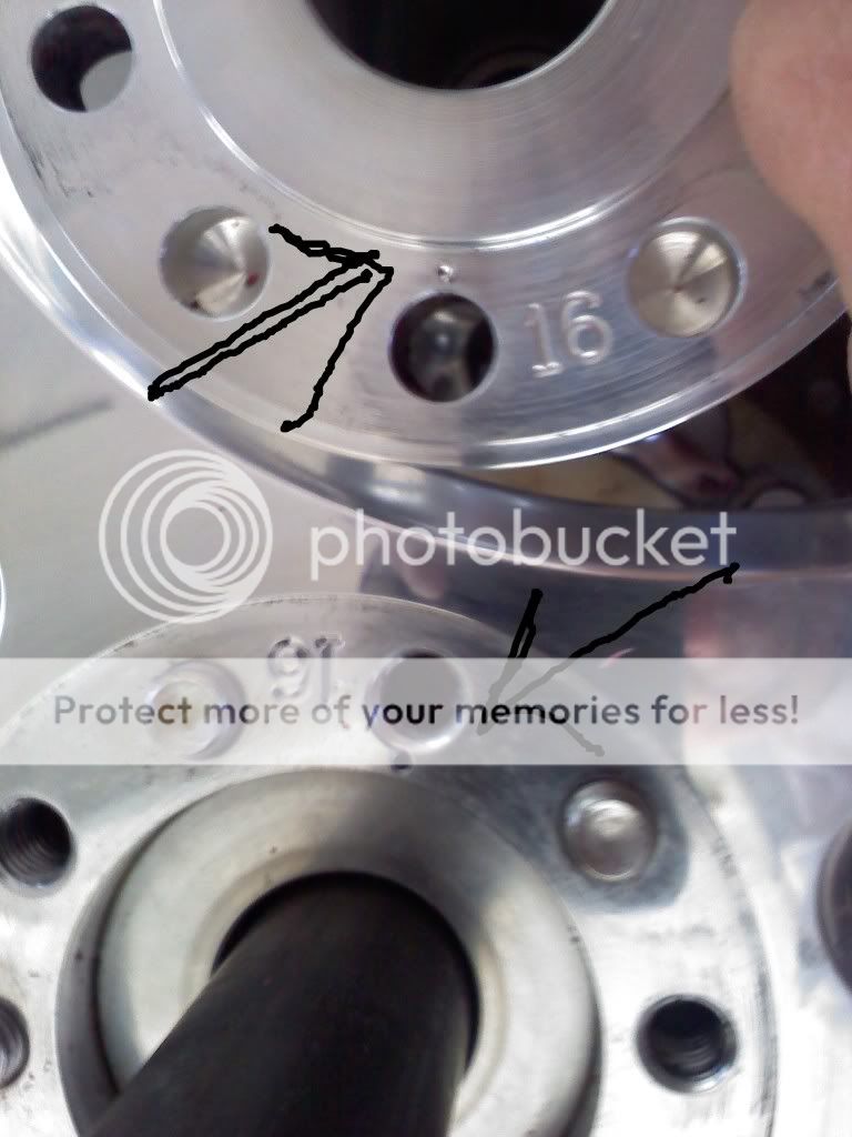

also when putting wheel back together be sure to line up hub in same position it was in. the 08 has marks already on hub and wheel but mark yours if they dont... and very important to have your axle ran thru wheel while putting hubs back on so everything lines up correctly.

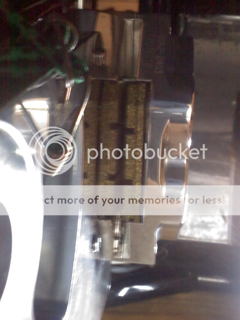

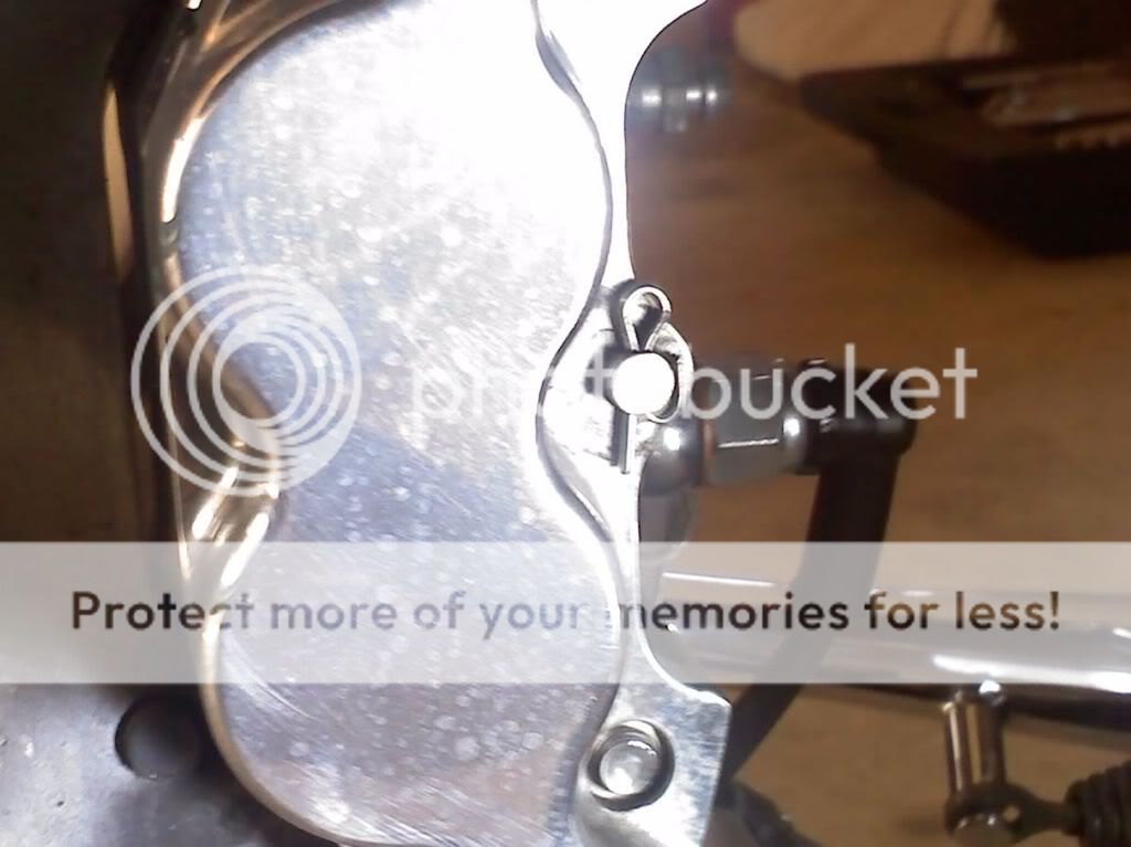

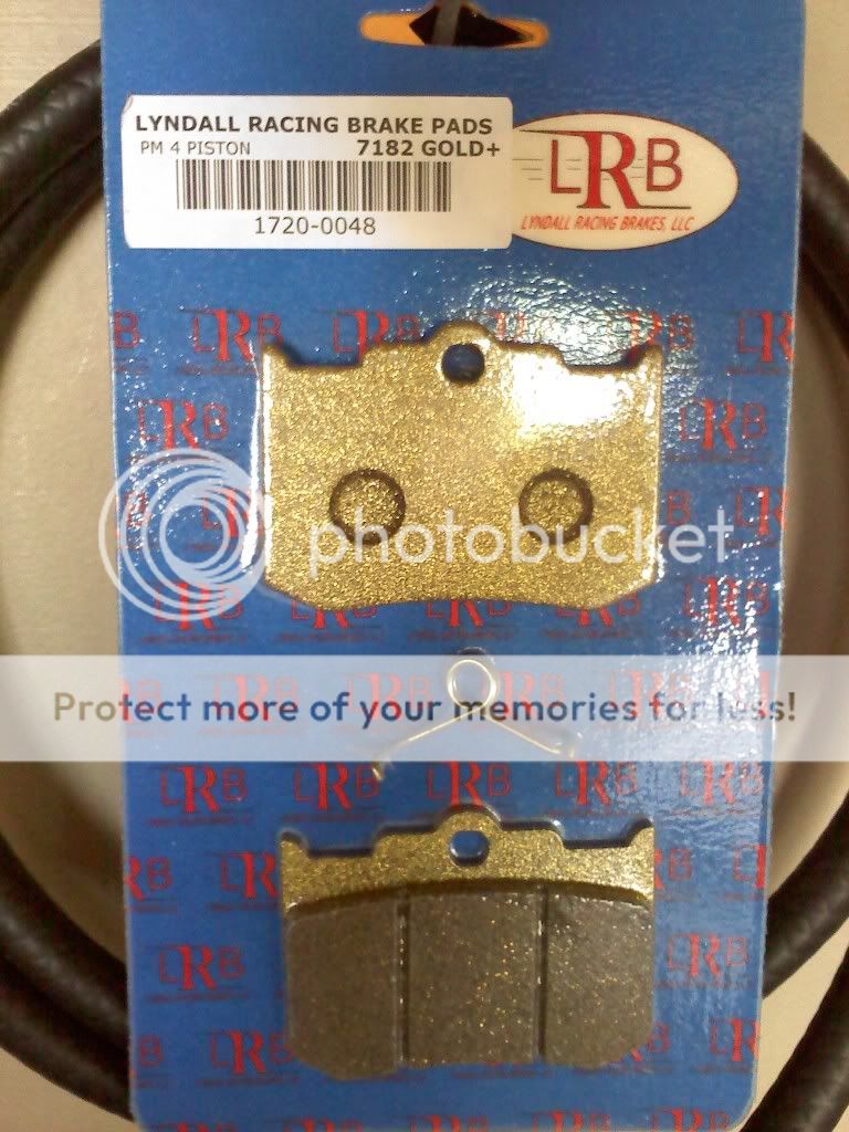

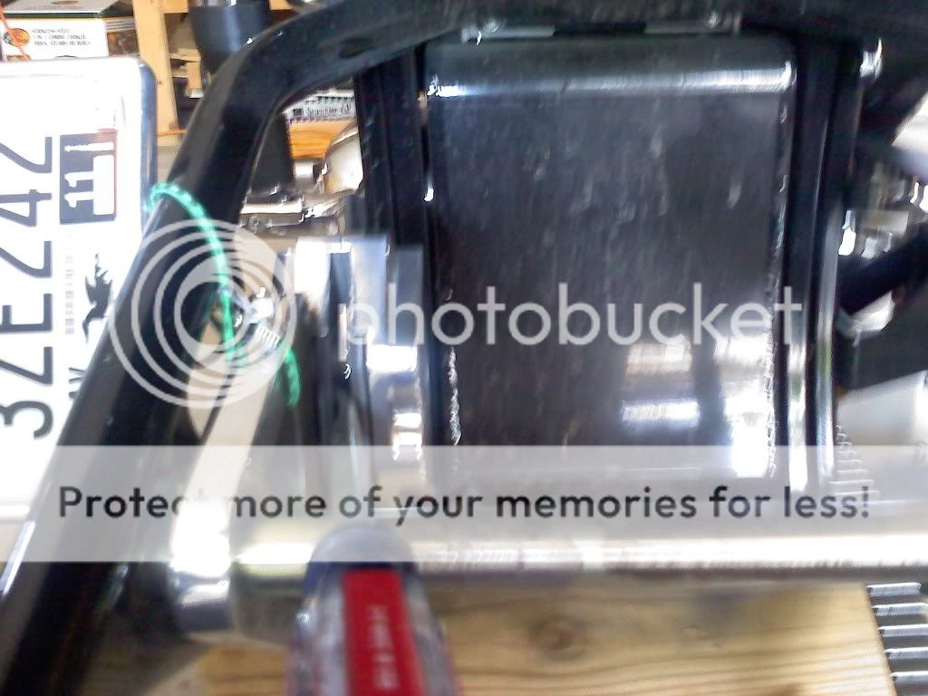

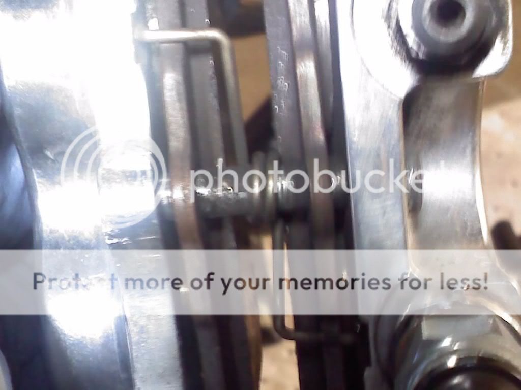

i also replaced the rear brake pads with the lyndall golds.. was told they perform better when wet and were $50 from bikers dream in atlanta. just like the how to says a very simple job... pull cotter pin that holds the brake pad pin and the pin slides right out.. rattle clip goes in between pads and clips on
to the back of pads. my pads were not worn that bad. i used a screwdriver against OLD pads to move caliper pistons back all the way.

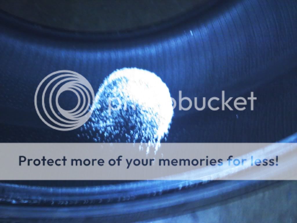

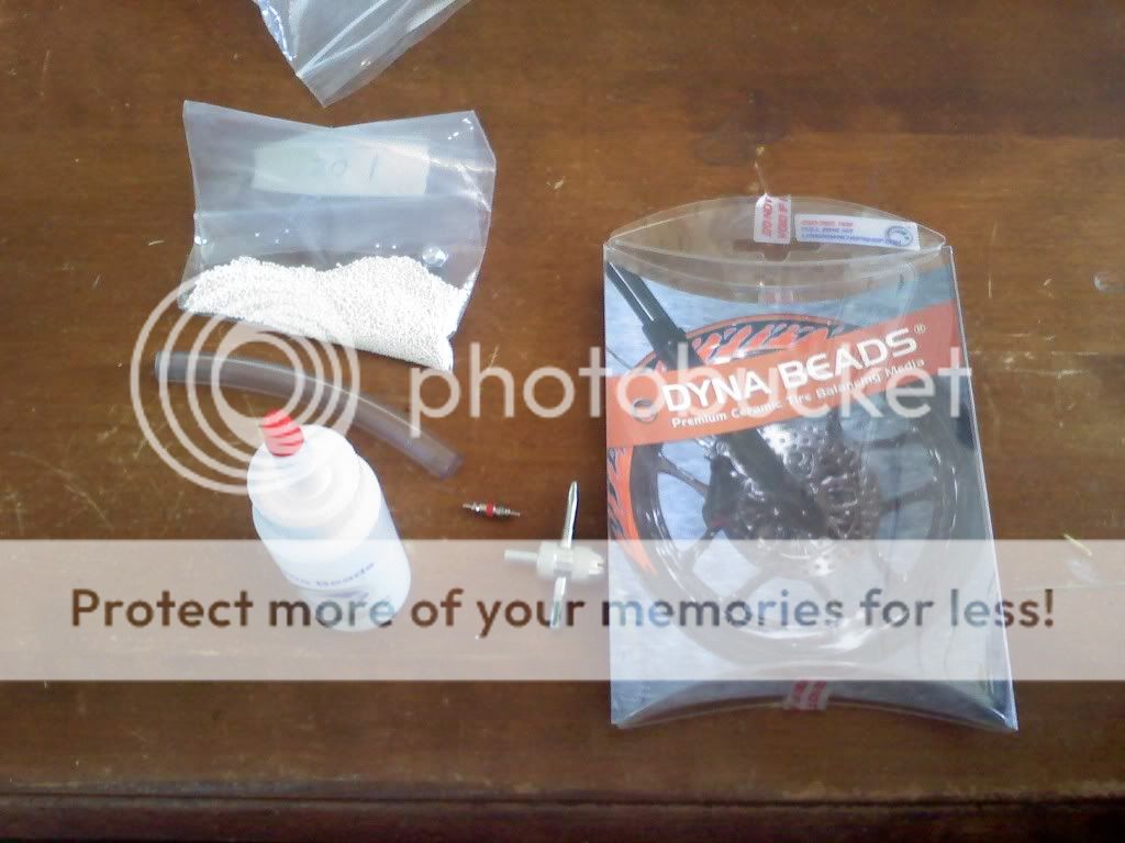

and last but not least i put dyna beads back in before reinstall and got in a short test ride:2thumbs:
