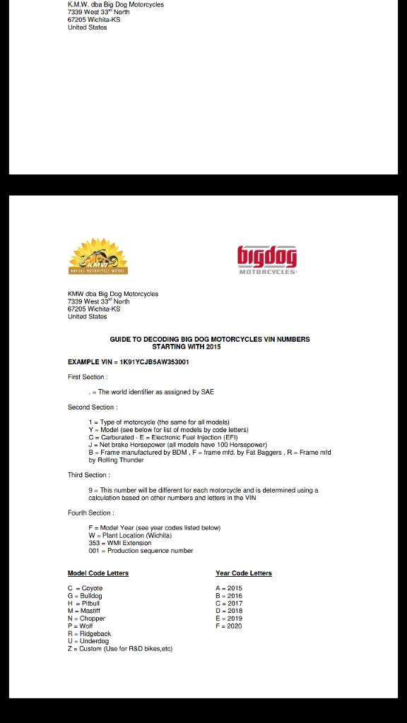

Wouldn't disagree there...thats kinda why I'm Curious to know if this mastiff frame is a BDM Frame.I wouldn't go cheap on the frame. Quality and track record would be my driving factors.
Should be able to tell by the vin will have a 'B'I believe it is a BDM frame. I know it's not a DT or RT. The upper motor mount bolt goes through the frame and threads into an aluminum cone shaped nut.
