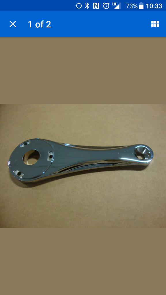

You just adjusted it too far down.
Like you said "can't get foot that high" well if you lower the lever too far you can't get enough throw to change the gears on the transmission.
The shifter lever has a very limited range of travel and has stops machined into the billet so the lever isn't really height adjustable as one may think.
Here's a good pic that shows the limited travel...

That is entirely possible that I "lowered" the shifter too far. I didn't know there was that much limitation on
adjustment. I did screw the rod out about as far out as it would go...I'll know for sure in the morning.
Chillin
OK GUY'S FEEL FREE TO RIDE MY ASS FROM HERE ON OUT !!
I never thought anyone would make something you can't adjust.
IT WAS the shifter pedal down too far. I feel like a Harley owner today!
Thanks for all the ideas and help!
