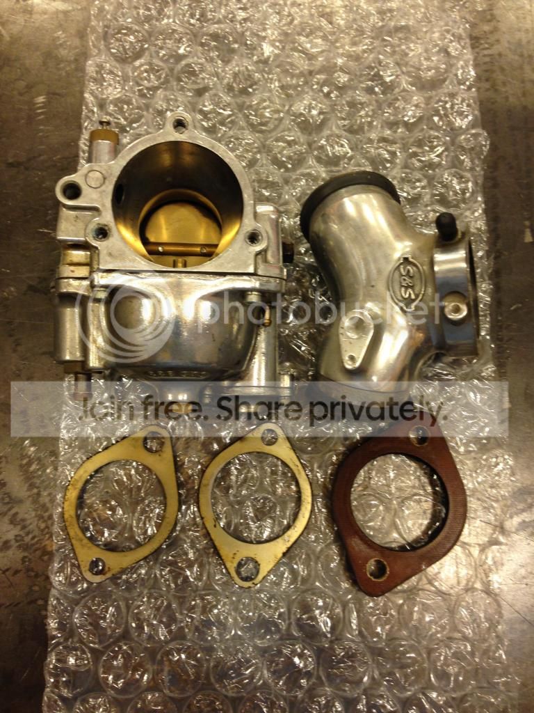

I have photo's on here of them. You do need to have the replacement plates to take up the gap they leave if you just pull them. Or you can have a shop bore out the restrictor plates to the proper size. Makes a big difference and surprised to hear someone still has them in their bike. They were only put in the 05's.

Well if you have the restrictor plates they are much smaller. Those in the picture are the replacement plates

Gotcha...........I thought those pictured were restrictor plates; like to see a pic of the restrictor plates if anyone has them.
Here is the difference in the two plates. As stated, stick your finger in the manifold first to feel if you have them in there. No sense in pulling the manifold if you don't have to. You can tell the difference in the restrictor plates and the spacer plates.
