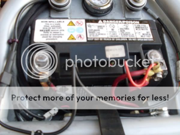

Yesterday I changed out some grips and shined up the bike well. I disconnected the speedo and dash, put everthing back together went to start and had some odd lights turn on, on my dash. Turns out I had connected it upside down. Re-connected it and i was good to go. Got home, turn the bike off and the above happend. I checked the batter and saw the negative terminal was a bit loose and there had been a short. The washer behind the bolt was a bit burnt and so was one of the connections. You can see it below. I charged the battery, got new bolts and after charging I was good to go. Woke up this morning rode for about 20 minutes, came back home went to take off again and the samething happend.

When you make the connections on the battery, the main ground cable and the main hot cable the two biggest cables should be right behind the mounting bolt head and washer. This will keep the other connectors from rotating when you tighten the bolts down and everything stays where you point them. If the smaller connectors are allowed to rotate, it pulls the wires out of the ring terminal or causes them to break from side load giving you all kinds of electrical gremlins. I have found my ground wire for my ehc broke at the connector due to it rotating.
This also will help keep the mounting bolts from loosing up on you.

yeah I saw that post a recently and have been setting up my wires like that. This was a shot taken with a second battery and I quickly put it together to see if it would crank and it didn't it. Just went out and checked the connections at the EHC and still nothing. Starter turns for 2-3 seconds, no sparks at the plugs and then everything goes dead. Lights, speedo, etc.
