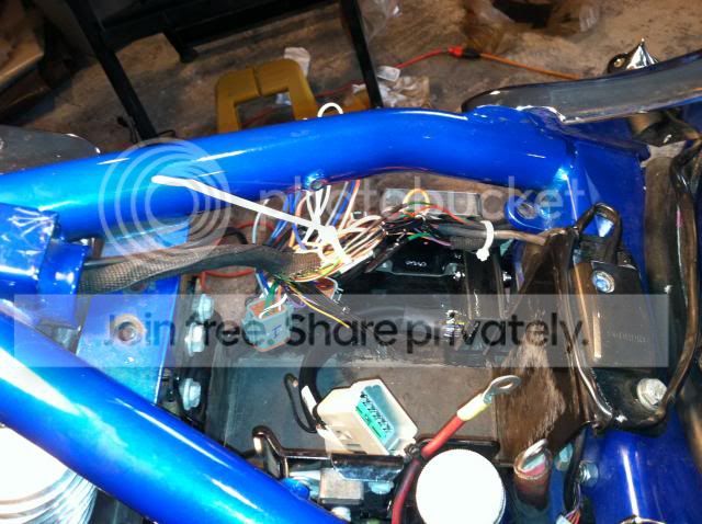

So two separate times, my bike died and had me stranded with no power to anything for about an hour before it decided to cooperate and restart. That was two times too many for me. My house is under construction due to Hurricane Sandy damage so I brought the dog in the heated house and installed the Wire Plus unit that has been on my shelf from Jake for the last two years.

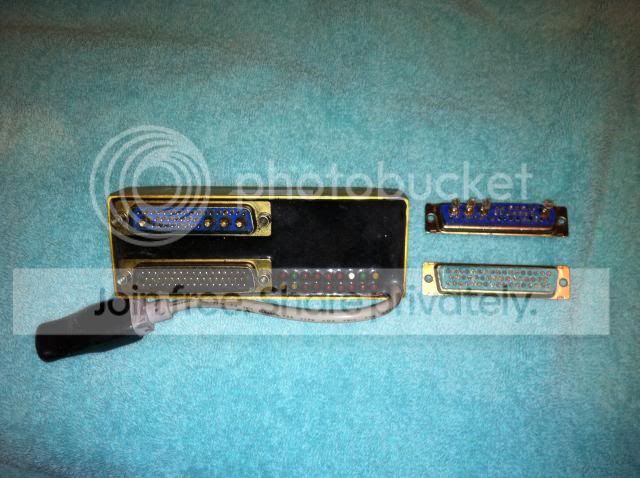

Read the instructions many times - took my time - thought things through - and now I am EHC-less :whoop:.
Was able to get a 5 mile test ride in and all functions seem normal :2thumbs:.
Here are a couple of pics in case they might help anyone.

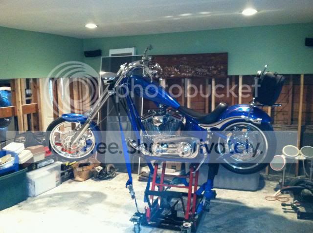

Dog is in the house
Deconstruction underway

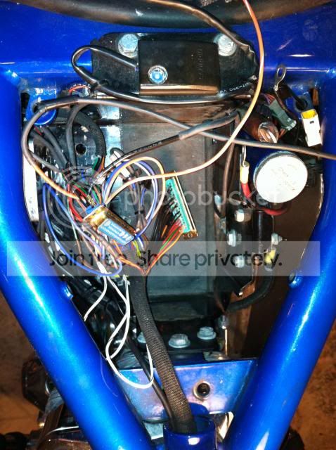

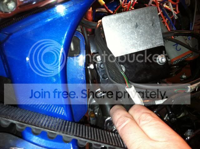

Control module mounted inside battery box with single bolt through back of battery box (second pic below)
Power Module mounted underneath battery box

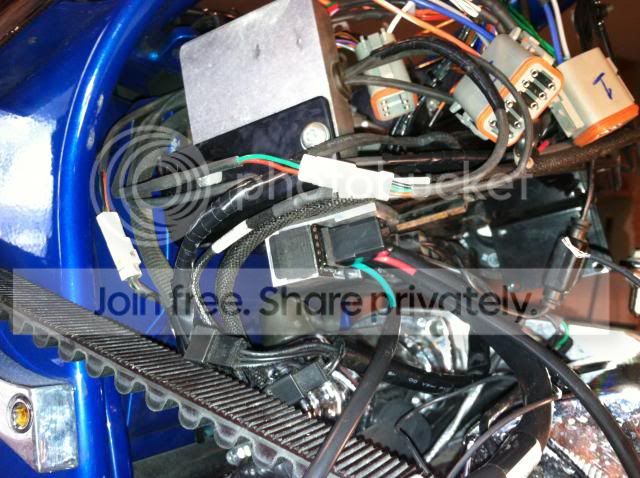

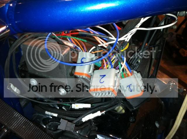

Deutsch plugs almost done - I was able to zip tie the completed plugs neatly into place where you see them (sorry forgot to get a pic before putting side cover back on)

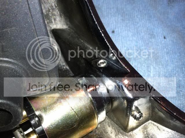

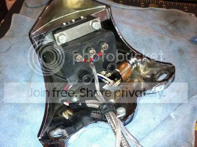

Coil cover modified for new ignition switch with set screws installed (LEDs optional)
No more EHC (priceless !)

Dog is in the house
