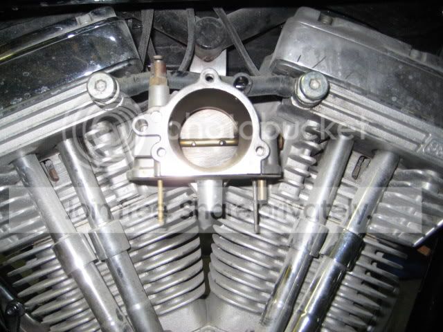

Hey guys just wanted to follow up on this.
I got the new carb for an 05 Mastiff in today and it bolted right up to my 04 manifold No problem.
Thanks for the help.
LDO
The Cleaner
by the picture I remember seeing, you will need a back plate. There's nothing holding the carb except the intake manifold. Not a good idea (IMO).
