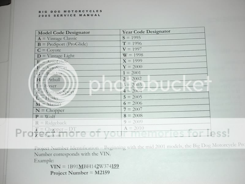

It's in your VIN #. The codes have been posted on here many times. Let me see if I can find it again.
The difference is in the motor mounts and some say the pegs were shorter on the DT or Daytec frame or better for short people. The RT or Rolling Thunder frame was recalled in that year for frame breakage.
Here it is:
If you have a DT it should have a T in the VIN. Mines an RT so I have an N. And your project # on the opposite side of the VIN will start with this code.
DonnyC
Based on this it's a RT because it has a N not a T. Thanks for your help. This site has been a strong resource of information. I really appreciate your efforts!
