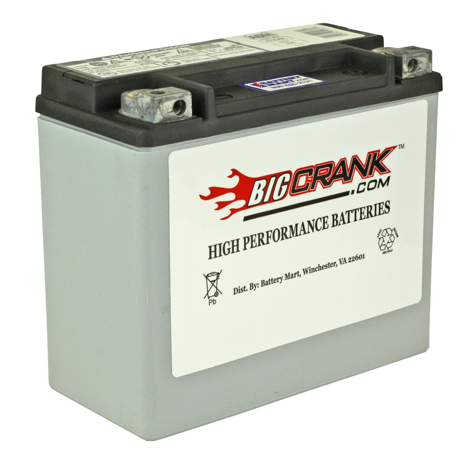

to add to the starting woes, even when it's warm, at first start in the AM I'll hit the starter button and there'll be nothing but a low level hum and then whoosh it'll fire right up. Not sure what that delay is indicative of but ... if that guides the decision on what oil to use

You happen to have a lithium battery?

Might want to look at something like this:
That's actually a good idea but right now I'm in an apartment until next summer and I have to park on the street with no access to an electrical outlet. I was thinking of just using hand warmers since they are good for 10 hours
