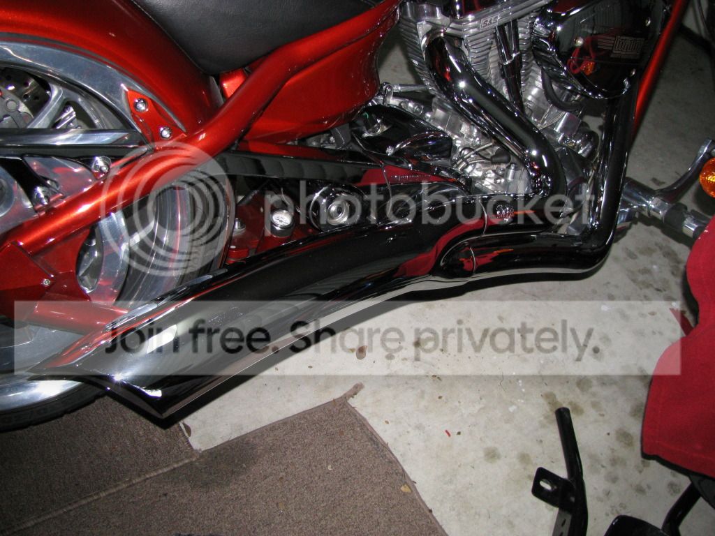

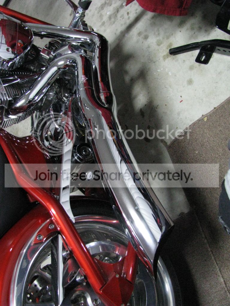

It turns out that since you had a backup, I decided to go ahead and MIG the broken piece and then weld it back on the heat shield. Everything went just right and it is installed back on the Dog and ready to roll to work tomorrow. Absolutely no evidence on the outside that I welded on the inside. I kept the heat high enough to get a good weld but short enough duration to not heat up the chrome. I alternated between each spot, cleaning as I went so I got good penetration.

Well,
It turns out that since you had a backup, I decided to go ahead and MIG the broken piece and then weld it back on the heat shield. Everything went just right and it is installed back on the Dog and ready to roll to work tomorrow. :whoop:Absolutely no evidence on the outside that I welded on the inside. I kept the heat high enough to get a good weld but short enough duration to not heat up the chrome. I alternated between each spot, cleaning as I went so I got good penetration.

Okay, so I'm going to say "Great Job".
But, without the cool Blue there isn't enough penetration and without the heat treating there is too much stress in a such a small piece.
Give it a couple hundred miles, and I'm betting its going to pop again. I sincerely hope not but.........
