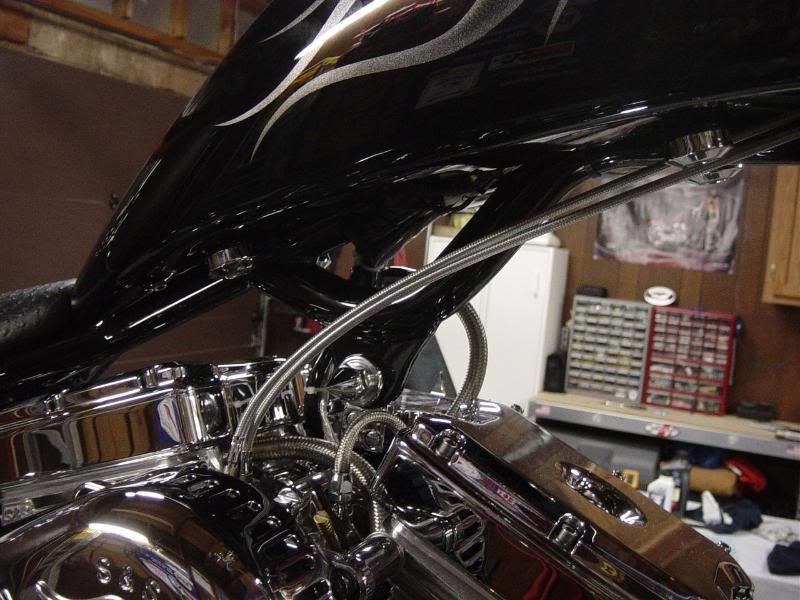

Yeah i don't have mine that way... put the vlv at the bottom ...
You can kinda see my current setup
