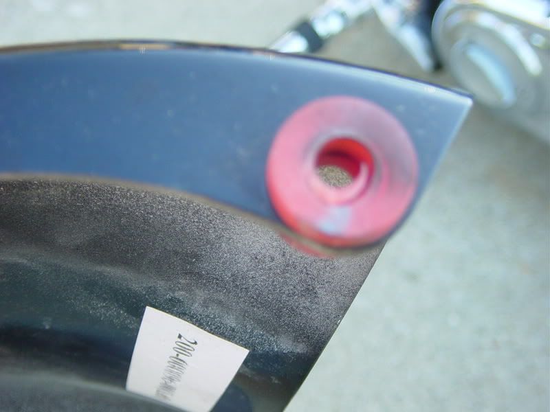

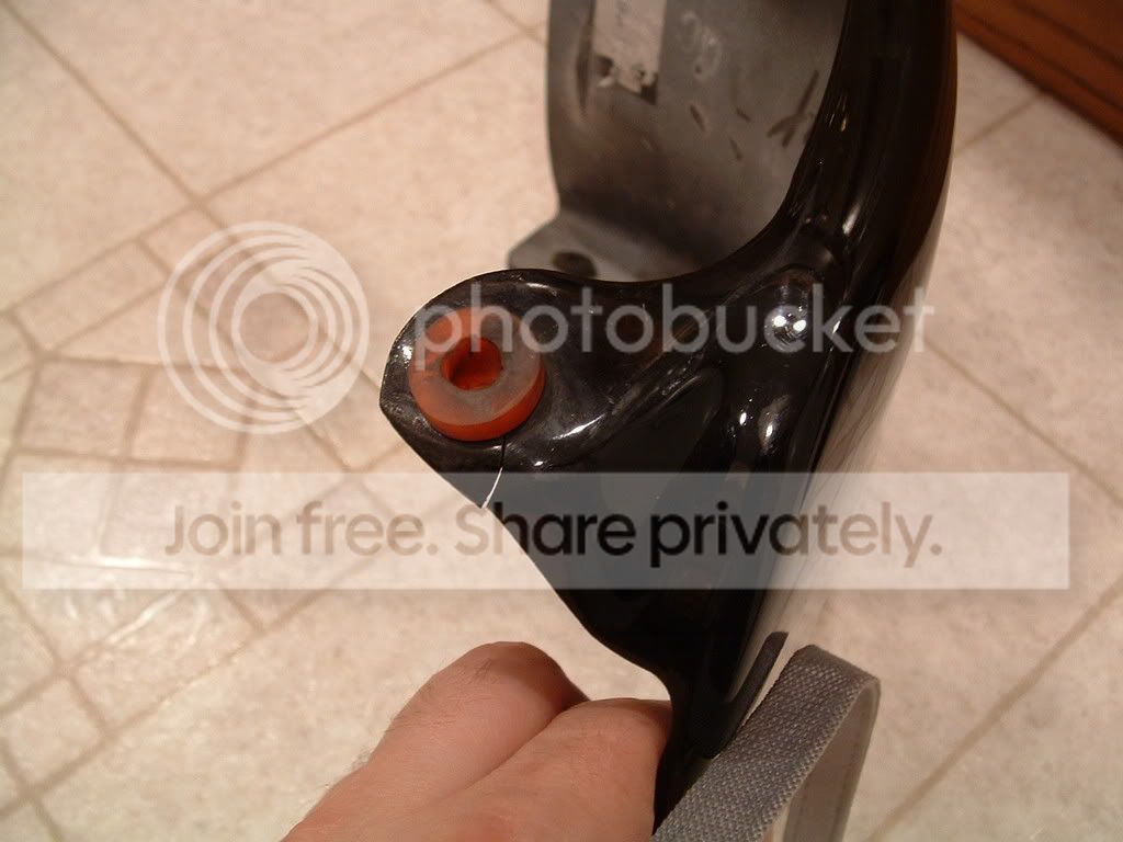

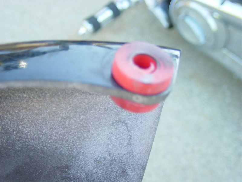

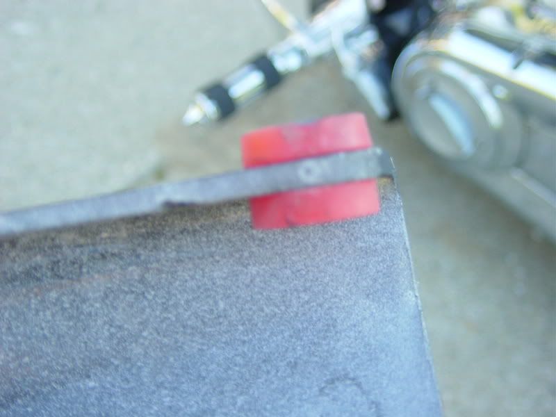

thanxs, now one other question isnt there supposed to be some type of grommet on the bottom hole also?
TLB08K9
well shit they didnt send me any of those with the kit, thanxs I guess I will give them a call tomorrow
When you go to put them in... try some waterless hand sanatizer... it will lube it for a bit, then dry completely within mins.
07bigdog
07BIGDOG
All you get is 2 grommet's per cover. The bottom uses the existing black grommet. They should also have sent you a piece of rubber to go over your belt guard, so it can't rub on the cover.
TLB08K9
well here in lies the problem with the existing black grommet, one of them is on I-30 between dallas and texarkana and the other was shipped back to BDM for repairs , so when I recieved my covers back that is all I got, nothing else. Well I called BDM and told them this and they shipped me the kit but no bottom grommets. Hopefully I can get them from either BDM or somewhere. Just want to see my bike in one piece for atleast a month. I'm sure BDM will ship them to me, heck when I called about the top ones I had them in 2 days :2thumbs: .

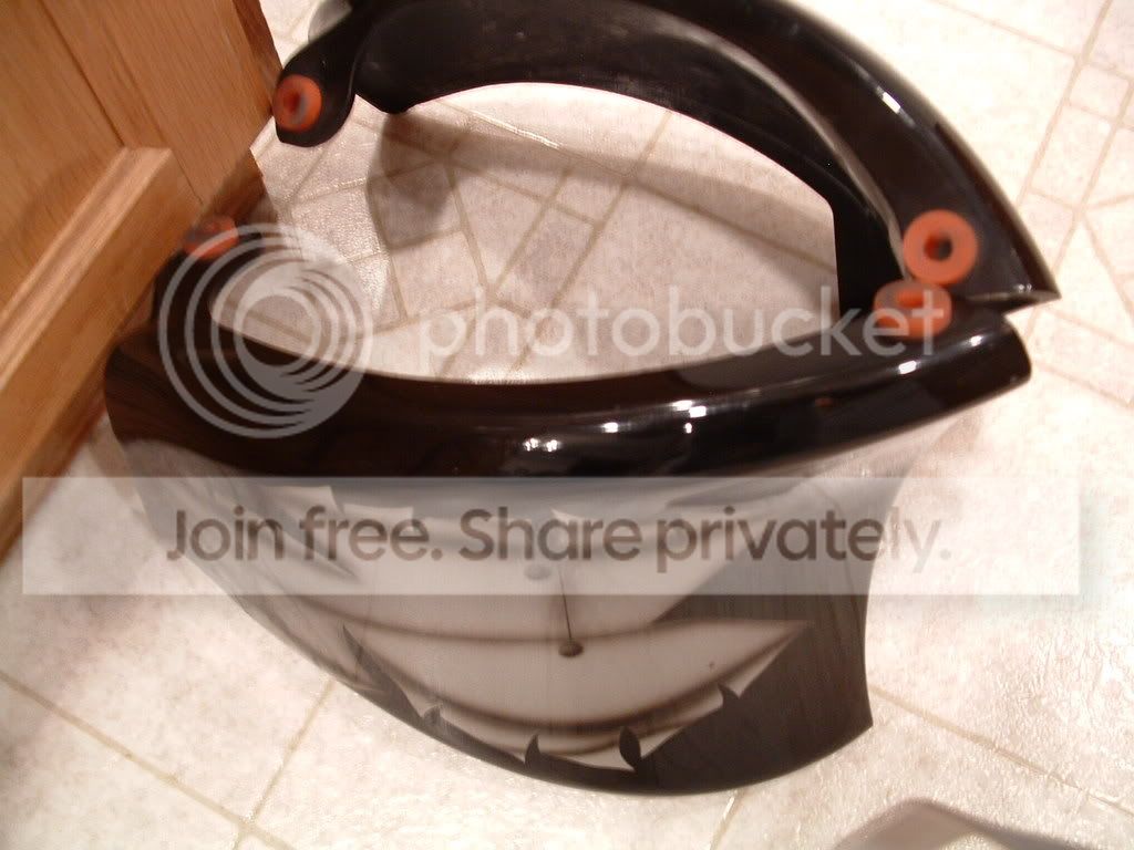

Ok- to follow up on all this, I got new side covers sent to me and still have ,my old ones. Problem is the same, no grommets top or bottom came wit new ones. So will have to take out old ones.......anybody have a good method off the top of their head on how to remove them w/out damaging them as I have no spares!! Don't want to damage the old covers if I can get away with it.
TLB08K9
Lots of lube, that is about the best you can do. Mine went in pretty easy with the wd 40 trick. should work also for removal.
Chopper Dave
SIICK!!!
if it were me..I would just order new grommets for the top and the 2 black ones for the bottom.....when I got mine back ..mine never had any grommets either....called my dealer and they sent me new orange ones for the top...and they sent me(had to order) the 2 black ones for the bottom...I just took my time inserting them in the covers
