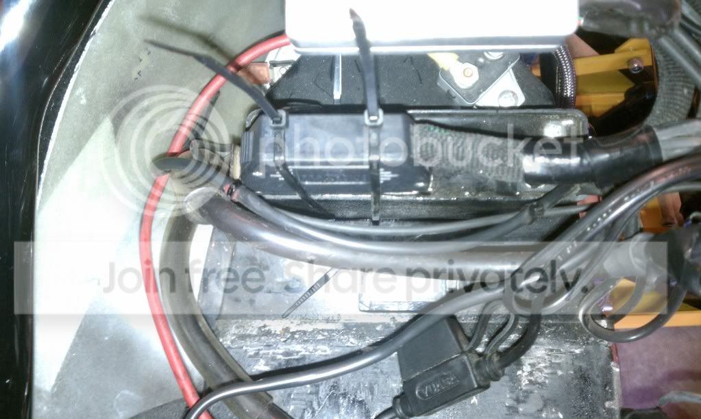

You got an 04, there was a recall on the power harness on the EHC. I would go ahead and watch this video.
It might not be it, but it's a free check. I posted a picture of my fix.
Big Dog is recalling certain 2004 Chopper, Bulldog, Ridgeback, Mastiff, Boxer and Pitbull motorcycles. There is a possible loose connection between the harness connector and the electronic harness controller. This condition may cause the motorcycle to experience intermittent loss of electrical power to various components, which can lead to, among other things, a loss of headlamp function or a vehicle stall, increasing the risk of a crash. Big Dog will notify owners and dealers will repair the motorcycles free of charge. The safety recall began on May 24 2010. Owners may contact Big Dog at 316-219-9121. NHTSA campaign ID no. 10v180
[ame=http://www.youtube.com/watch?v=GIO8xd5Ps9s&feature=youtube_gdata_player]O4rigid ehc connection issues - YouTube[/ame]
