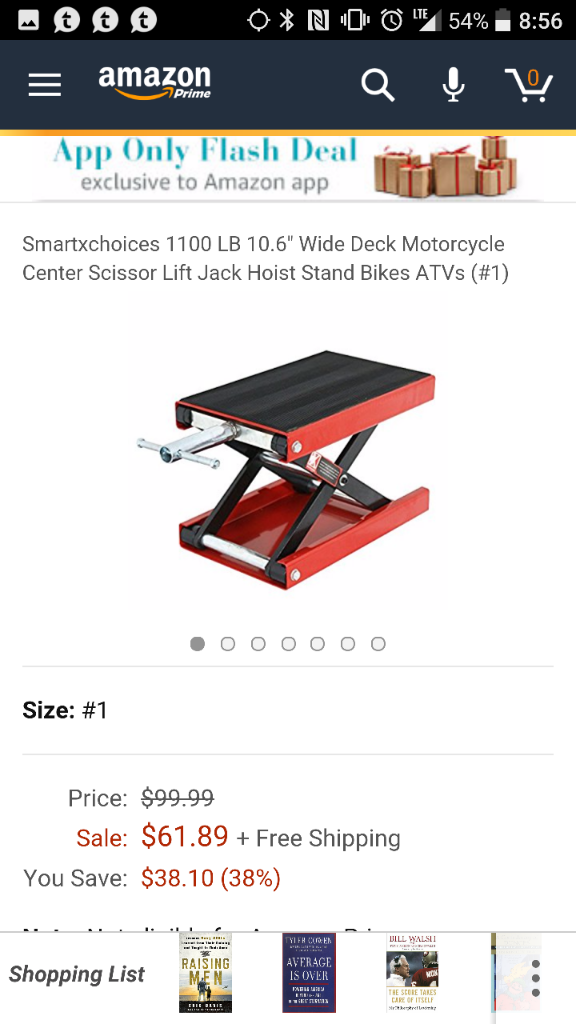

That's a good idea!Based upon how these bikes are designed, your better off blocking the frame, and then tie it down. I have Condors, and even though your pulling forward by different points on the bike, you start to collapse the forks pretty good just to keep it stable. When you block it, it can only collapse the forks so much before the bike is hard down on a wooden block under the frame. Just don't want to put any extra stress on the K9 forks or front hubs/rim. I am probably going to make some sort of scissor platform to slide under the frame before I strap it down. I don't see this being any different than my hard tail dragster.
I was just thinking bout this the last time I trailered I was thinking about bringing my MC jack but at the time I was thinking of the big one and it's got wheels which isn't a good idea haha. Not sure why I didnt think of my scissor jack I have for the table lift....
