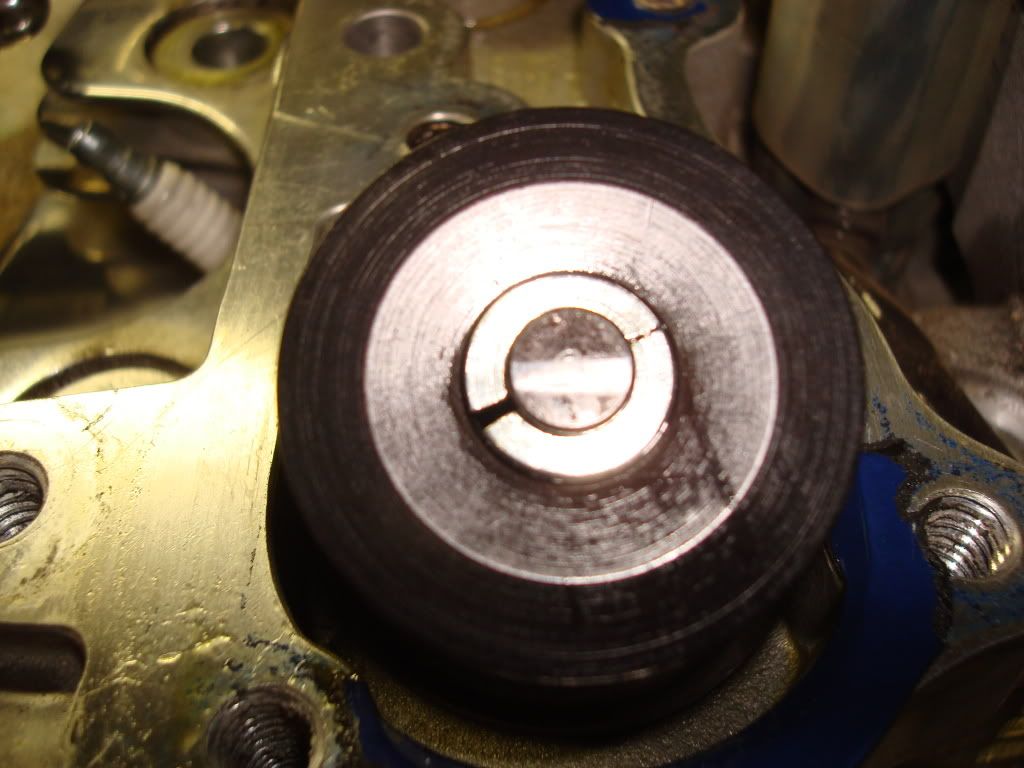

Doesn't matter what the guides are made of. The TP problem is all about geometry. The bronze guides will take longer to wear than the cast iron stock guides. They will eventually give up and if the rocker boxes aren't changed, you'll have a problem like the above pictures.
