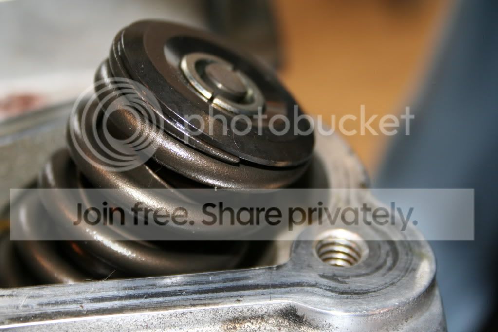

Pulled the TP (Terrible Product) Rocker Boxes off today and there is no visible blow by from the valve guides!!!:whoop: New (used) S&S’s going back on!:2thumbs:

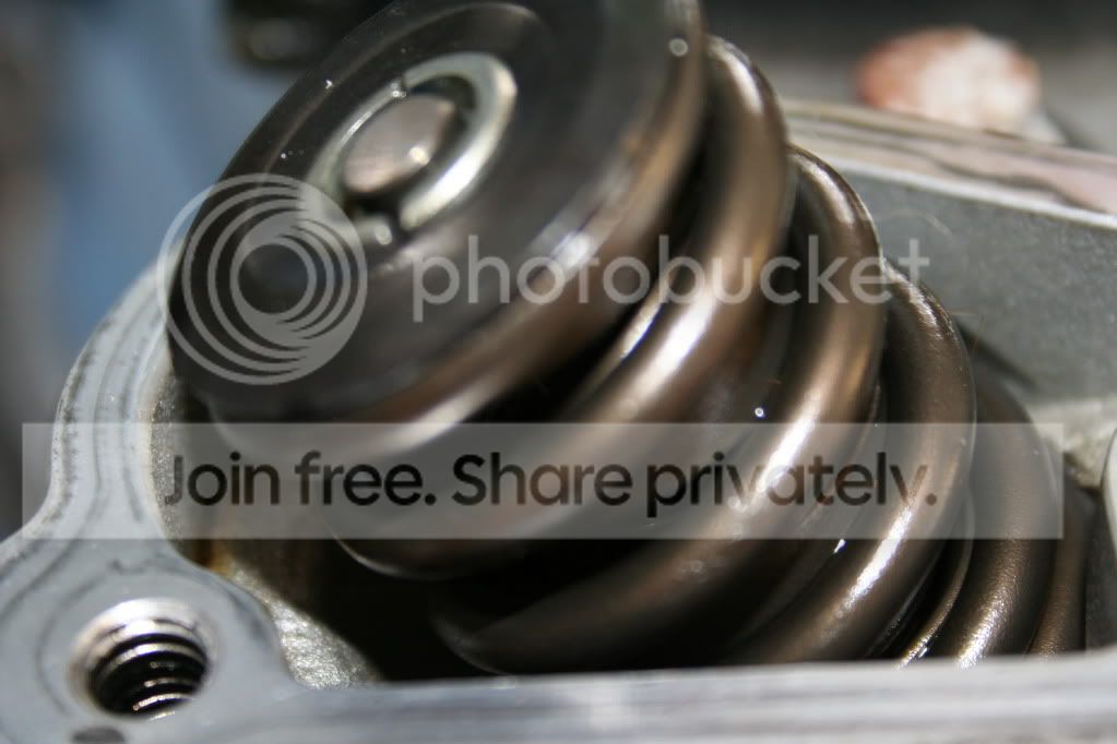

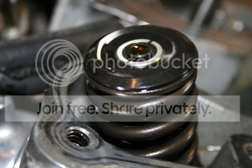

BB, Looks like a pretty good wear pattern from what I can see. Wipe off the top of the valves and take pictures of the tops where the rocker contacts the valve.

BB if you will post some better pictures of the valve stems where the rocker roller contacts the valve stem, I can tell from my experience. Also how many miles do you have on your bike? I have about 12k on mine and I wasn't far from major trouble.
