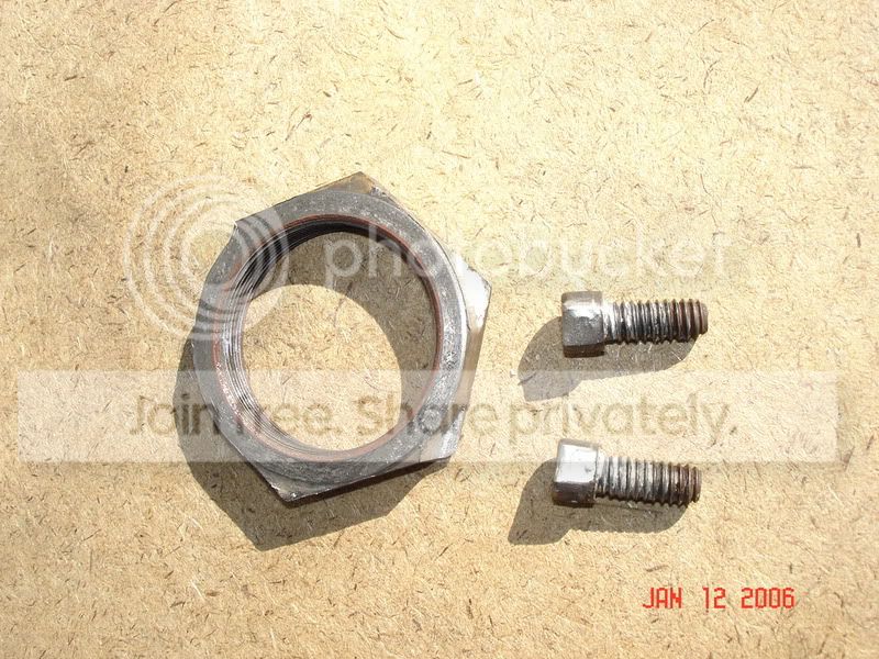

This nut has two lock bolts that should be torqued to 7-9 ft lbs.

Make sure you use good loctite as mine backed off a couple years ago and wore down the lock bolts. Haven't had an issue with the o-ring though and no other issue with the nut after it was replaced.
