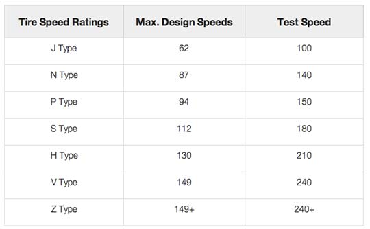

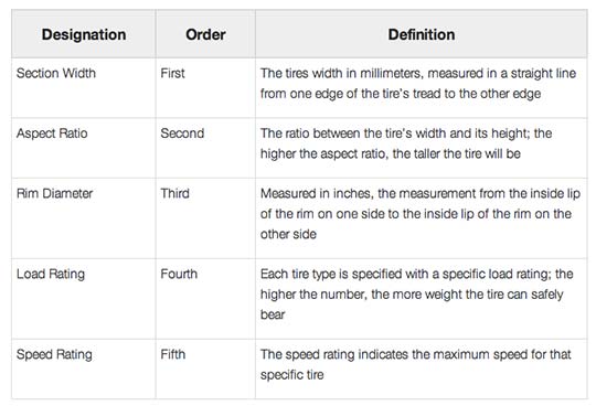

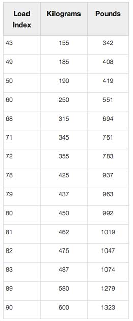

Choosing the wrong tire can lead to tire failure or worse…Replacing your tires just requires to copy down the numbering of your current tires. Problems may arise, and it happens more often that you can think, when upgrading to a new brand or size. First things to do is to match your tires to the speed and load ratings. For example, no racing tires on a cruiser and tires adapted to the weight of your motorcycle. There are 4 main motorcycle tire designations (cruising, sport, off-road and racing) For each designation, you need to understand and how to convert 3 different measuring systems used by tire manufacturers, inch/metric/alphanumeric.. The Inch Measuring System. Used for stock and very basic tire sizes, the inch system of motorcycle tire numbering does not see common use. The Metric Measuring System. The most common of the tire size designations, known as the metric measurement, begins with the section width. The inch system is akin to the car tire measurement system..The Alphanumeric Measurement System. Invented by the British and largely phased out by metric tire numbers. Alphanumeric codes are uncommon on today’s tires.
Below tables giving the tire size, speed and load rating conversions across all 3 numbering systems.

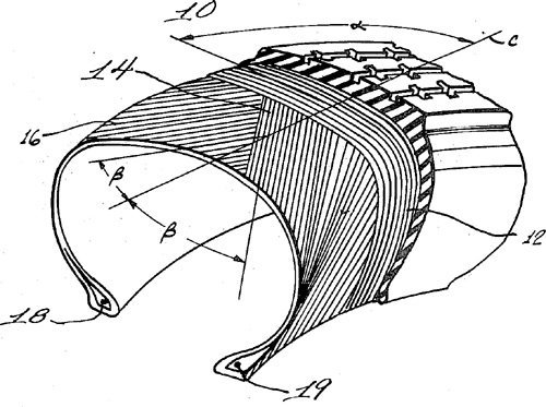

Noticed a lot of members switching to ME's and having good results- There's a specific reason the Metzler radials do not exhibit the same type of lateral splitting as the Avons (if the failed Avons were indeed radial models)- Metzler makes their radial carcass tire that is also steel belted around the circumference. So that added belt should hold the tire up to a lot of TQ / keep it all together. The Avon radials do not have added belting so heavy TQ is eventually going to pull the radial bands apart or cause tread separation. This was a big issue for car tire makers back when radials were introduced.
Dunlop introduced rear radial models specifically for HD / Victory, which are also reinforced / tested for heavy bike / high TQ type of use.
Michelin not sure I have not checked. But you rarely if ever hear about an issue with a Michelin tire (other than the cost to buy one!) :D
So Avon's radial rears are probably peachy for sportbike use, but seems they have not upped their game to make at least a few rear radial models suitable in the same way Metzler / Dunlop have on certain models of their radials.
Bias ply belted tires should never split due to how the design is laid out- but they are stiffer due to this so they are usually not the best handling tires. One benefit of bias besides strength is a "flatter" profile, and they won't grow taller (as much) as the bike speeds up like radials can. Here is a pic of radial vs bias ply construction on a tire. #10 & #12 is radial construction, #14 & #16 is the orientation of bias ply design.
