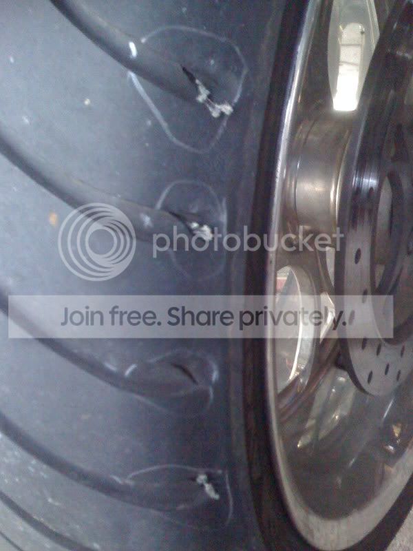

i was riding home last night and about 1/2 mile from house it started to act funny and get soft feeling as i got near house it started to get rough figured must be tire goin flat. Could not find any problems with tire today except this. What causes this?

you had to of ran over something. they look like cuts to me. by the way, clean your wheels.

Did you check the pressure to see if the tire was going flat? It looks like you ran it low on air. Is the tire old? How many miles on it?

That's an odd place to have slashes on the tire.
Being that it is slashed rather than punctured looks to be a malfunction of the tire. Probable cause i don't know.
Also i have seen people that have had their tire's cut that look like that.
Hope that's not the case.

Looks like someone is trying to get you...!!!! slashing your tire... :spank:
Doesn't look like something you could have ran over???:zz2cents:

My buddy's tire just cracked do to "weather checking" just about like that last year.
Manuf defect, looks to me.
