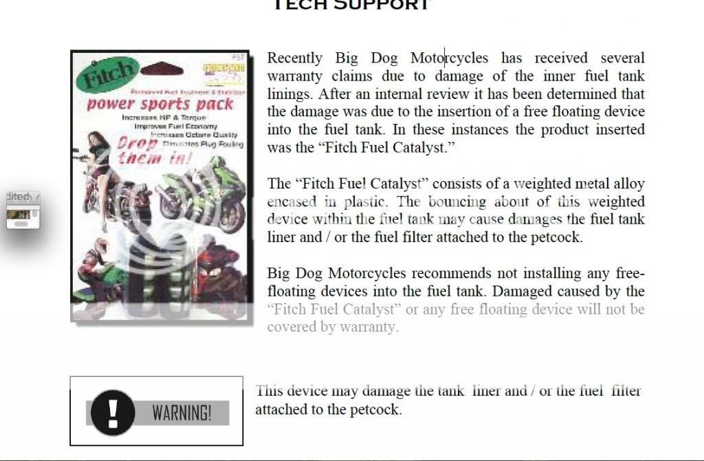

Hey everyone I am having aproblem with the liner breaking down in my gas tank so I am sending it to fuel tank services to get relined and why moving the tank around I heard something rattling around in the tank and I retrieved to black plastic cage looking things with 4 metal discs in them was just wondering if anyone new what these could be ....thanks

Its called a fuel gizmo, made by "Fitch". Big Dog had warrenty claims pertaining to these devices because they would bounce around in the tank causing the lining to seperate in the tanks. Take them out if you can...
Brew
Thanks Wood, I've mentioned it before some time ago! Someone else had an issue with the liner peeling due to this thing... :2thumbs:
mybgdg
Thank you for the reply and the help that is exactly what they look like and yes they destroyed the liner do you no if they were actually put in there by big dog or was done by the previous owner of my bike
