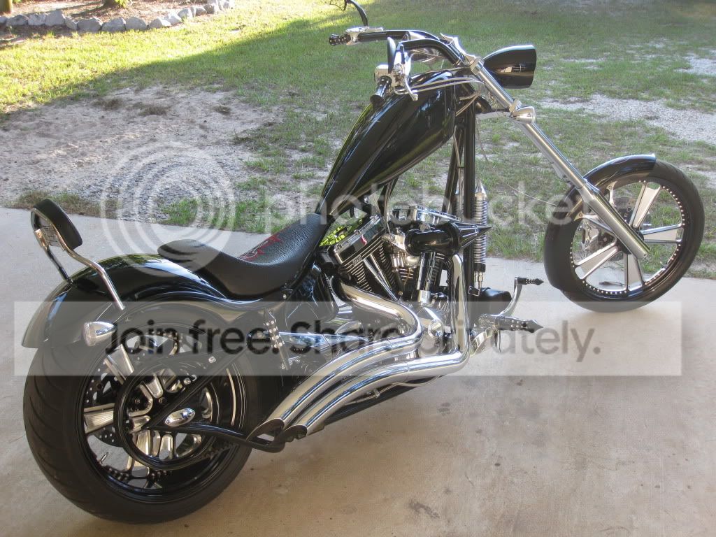

BWG56
:hi:welcome:hi: nice write up and I really like the paint job, is that silver or gold on the top of the tins?

BWG56, you have very nice paint, as well…. mine is silver. :)
