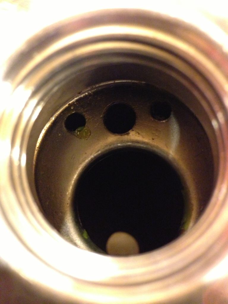

SO when i look in the tank, assume i'm looking in through the gas cap, what am I going to be looking for, and on what side of the tank? Thank you

Look forward towrds front of tank.. ul see a ledge. U should be able to see the nipple sticking up.. I started mine up and warched the tube wobble ..

It appears that way.. mine would of been in the middle hole.. can u feel it under that ledgeM or see it ?
I felt under there with my finger but didn't feel anything. Just got back from bike night. Didn't have a lot of time to mess with it. Ill get some light down in there tomorrow. Where does it run to? Assuming its attached on the other end but where?
PROBLEM SOLVED!!! Looked in the tank and found that the vent tube was intact. Not very stable, but intact still. Took the tank off, and discovered that the rubber tank bushings had rubbed themselves out of round, and worn themselves down completely on one side, and had a terrible vibration and rattle. Took some emory tape and wrapped it tight until everything was fitting tight and re secured the tank....rattle and vibration gone. Will order new bushings, but also discovered that the tank sits directly on the frame, so we'll have to put a strip of 1/8th inch strip of rubber on the frame between the tank and frame.
