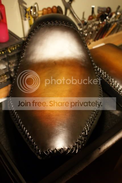

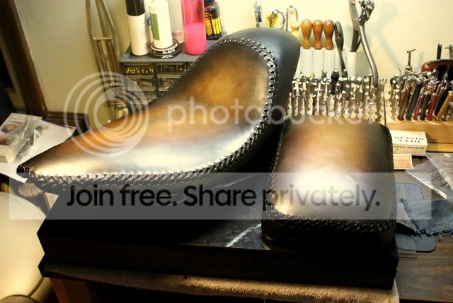

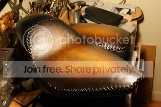

Hey Guys, I thought I would post some pics of the before and after pics of dying my Tan bobber seat Black.
First I started with washing the seat with soap and water...after Drying I wipe seat down with "Angelus" dry cleaner and spot remover.
Then I put two coats of "Lincoln Black shoe dye" after the dye drys I needed to wipe the entire seat with same solvent to take out the purple hue that comes to the top of the dye and to remove any excess dye.
Then I use "Meltonian All purpose cleaner & conditioner" to bring out the luster just like new finish! I did go one step further and applied a nuetral leather paste but this made the seat look to glossy so I took it off. enjoy the pics!!!

That came out real nice !!! :2thumbs: Im waiting for my seats to come back from Rodger at RMH customs.. He did a great job with the color fade..
JoshT
You got me.... all I know is that it started out tan and he used several different colors of dye. Rodger is a member here so you might wanna ask him..
