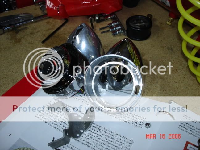

Never done it myself but the service manual doesn't indicate that you have to remove the speedo to do it. I suppose if you can get at the allen screws underneath to release the ring you should be okay. Just be real gentle with it because they are a bit delicate. I found that out the hard way with the shop that installed my hand controls. At first they said it was bad but then after I looked it over real well it was clear they just weren't careful and pulled the wires loose from it. Then when they put the new one in they didn't line it up right so the lights aren't as bright as the should be. I would fix it but why whene I have a new Dakot digital gauge coming.Thanks! that should do it. Think i am going to have to remove whole speedo to change just board??

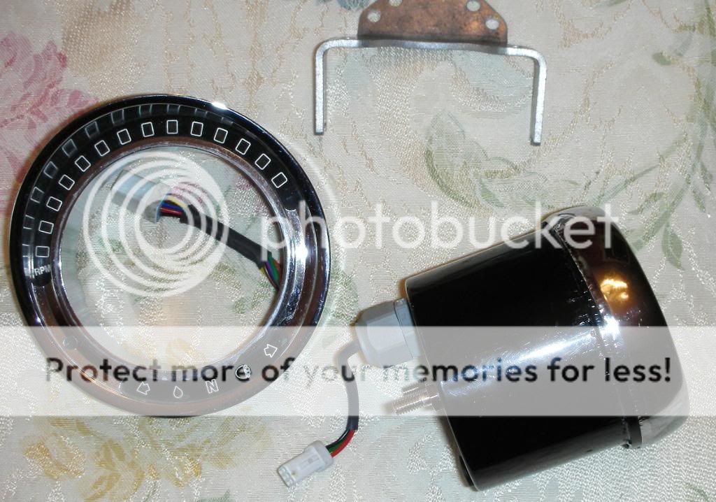

The speedo comes out of it's case/shell and the outer bezel holds the speedo and outside of it is the tach board. You can get to the tach board without removing the speedo but it's only held in by the retainer with the two small nyloc nuts. Be easier to take it all apart then will enable you to clean it up and give it a good shine. Easy to do. The Service Manual has the full description of this assembly and I think I have a pic of it in my gallery somewhere but I'm not looking cause there are too many pics in there!Thanks! that should do it. Think i am going to have to remove whole speedo to change just board??
raywood - i did the install...... cake with your pictures! Thanks! but..... when i turn the bike on the LED stays on the green for a few seconds as it should then it starts jumping. do i have to reset or somthin???The speedo comes out of it's case/shell and the outer bezel holds the speedo and outside of it is the tach board. You can get to the tach board without removing the speedo but it's only held in by the retainer with the two small nyloc nuts. Be easier to take it all apart then will enable you to clean it up and give it a good shine. Easy to do. The Service Manual has the full description of this assembly and I think I have a pic of it in my gallery somewhere but I'm not looking cause there are too many pics in there!
