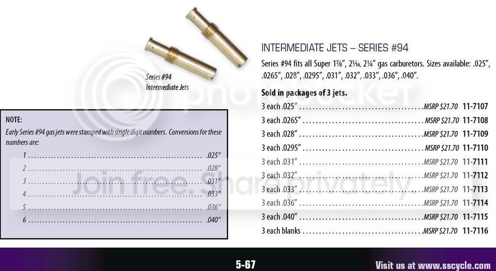

What jets do you guys recomend for a 117 with Super G . Hooker Troublemakers and 90 degree 4 1/2" foward facing open velocity stack? I have 76 and 35 jets in it now. The Troublemakers are just like the V&H Big Radius pipes and have the baffles in them. When I install the velocity stack it stumbles really bad. You can here it sucking in huge amounts of air. Any suggestions?

Ok, where did you get a .035 jet? S&S doesn't make them. Did you have someone cut one for you?
I would pull the bowl and first double check what you have. When you got your V&H (if you got them from BDM) they would have come with a 31/76 combo.

OOOP's it's a .031 jet. It's the jet kit Big Dog recomends for the Vance & Hines big radius pipes.

06 Mastiff, 117 with Super G, Doherty Power Pacc, and the Troublemakers. Until I removed the bowl vent I had problems. I currently have a 32 intermediate and 78 main jet, but I am going to drop the intermediate to a 31, if the weather cooperates this weekend

I run a 32 and a 74 combo in my 117 with a S&S desperado air cleaner and factory pipes and it runs great. Just my 2 cents
