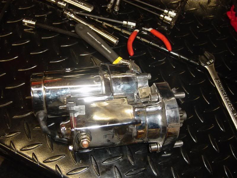

Well, after spending some time and money to check the wiring on my bike, I have found that my starter was indeed bad. Should have checked that first, huh? Ah, what a dumbass I am!! Anyway, I took the starter to a local shop that I trust and had it tested. It was crap! I need some suggestions on what brand I should invest in and how much money is necessary for a good starter. I have been given suggestions for Powermaster and about $380. I have found other starters, like Accumax for $220. Any feedback is greatly appreciated! :spank: :job:

that spyke starter will not work on "05 and later big dog's , the only starters that will work on '05 and later models have to come from big dog, the reason being is the shaft that comes out of the starter is different, '04 and earlier you can use any starter that will fit a late model softail, but '05 and later the starter has a gear on the end instead of a splined shaft and the only place to get it at this point and time is from Big Dog

I called my local starter/alternator rebuild shop today.He said he can rebuild my stock starter and make it alot stronger than stock.He said it would turn a 124 with no problems.He also rides a HD with a 113 incher built his own starter.Price for me around $150.00
