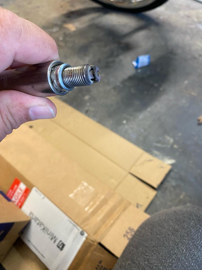

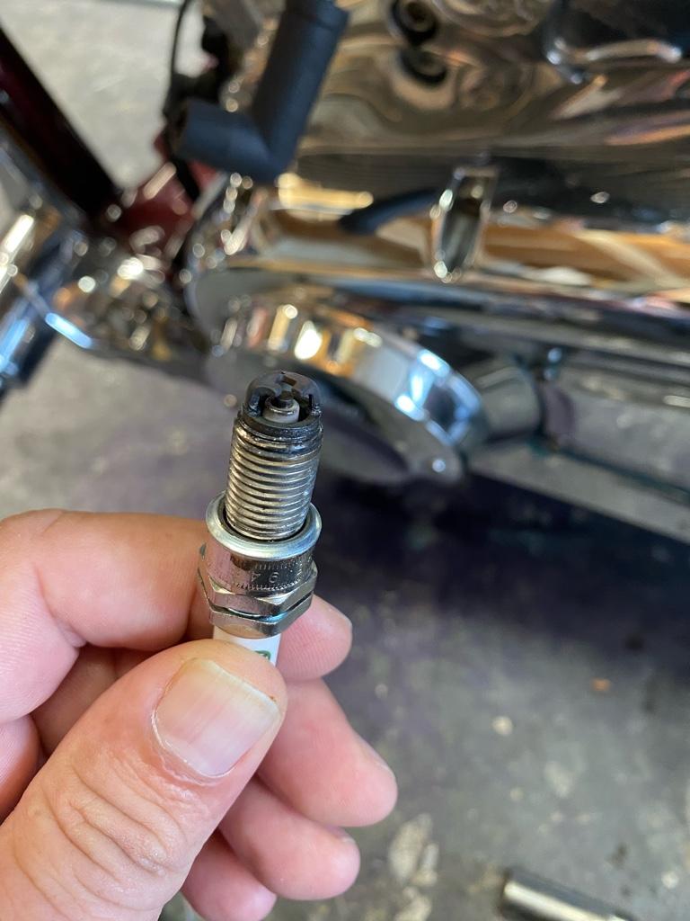

Read the spark plug. Porcelain is white it says lean is mean. Porcelain sooty black, it's over rich and fouling plugs is the stumble.
Cam my be too top end happy so a shift down may be needed. Can't ride it to know a plug stumble or a fuel stumble so it's all a guess on our/my end.
