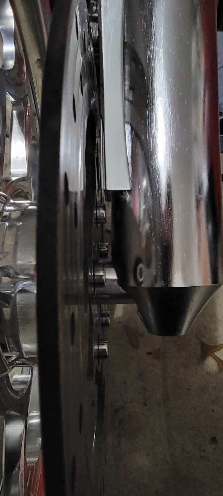

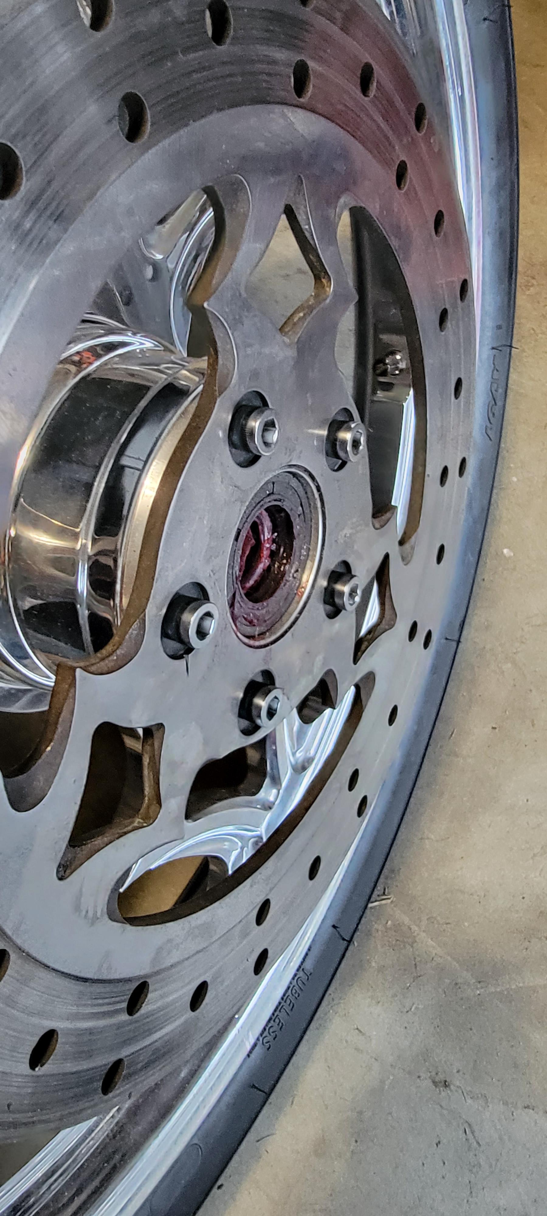

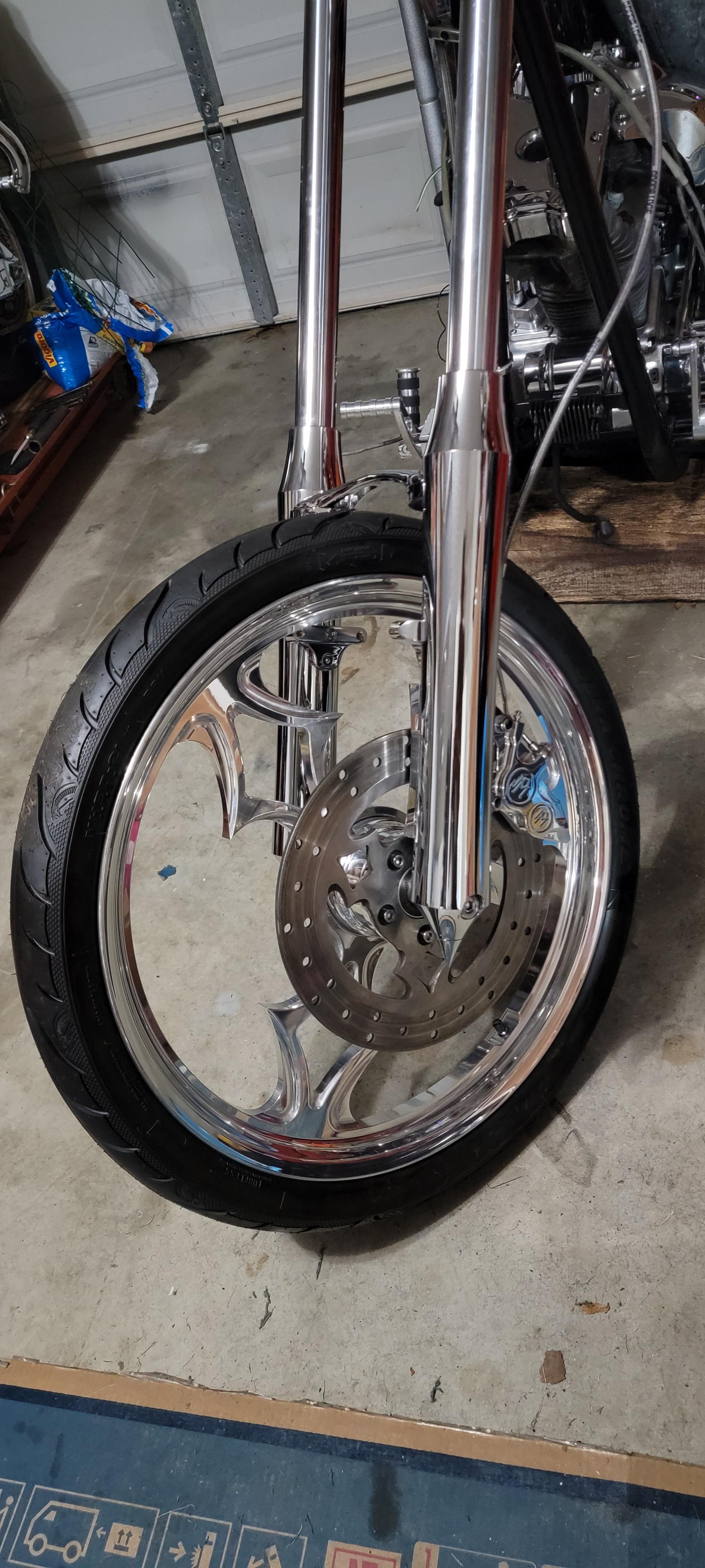

Here's some pics of the front wheel rotor with the cap heads. I removed the hub and rotor, replaced the bearings, cleaned the wheel inside and out repolished and replaced the rotor bolts. The forks and brake caliper are new via hdm.
Working on the rear wheel now. I only have a few hours a week free to work on my bike but I do everything myself and I enjoy it.
