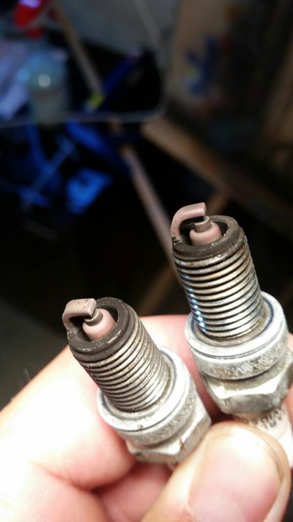

From looking on here most people are running at least a 31 intermediate, 50-60 air bleed and anywhere from 74-78 main. First time I checked the plugs they were a little light so I figured she was a little lean but when I just pulled to change to the E-3 they were a little sooty, so I'll have to get a couple sets and do some testing. Here's what they looked like when recently pulled.
