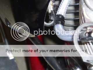

Just installed a set of Magnum Chromite II spark wires on the K9. PtNo 3030C used, but not without complications.
These wires are approx. 1/2" shorter than the stock Accel 8.8mm wires. They do reach, but the difference in length caused the metal cup covering the braid to rest on the top cylinder head fin on each side.
I added a small Adel clamp to each coil mount screw, and used these clamps to anchor spot ties to hold the wires in a position where the metal cap cannot touch the fins.
Looks good, at least I like it, and runs good too. 'Course I'll always carry the take-off wires in the tool kit...
Here's what it looks like, and what I did to stack the deck in my favor:
