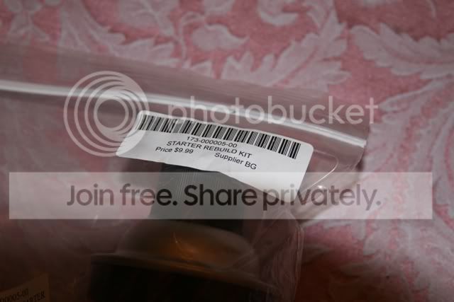

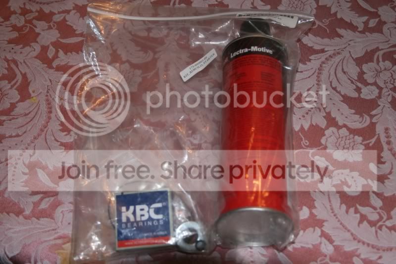

Okay went to my trusted dealer today to get more info on the kit that has been discussed.

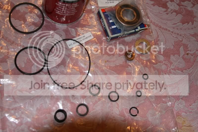

Here is is what I understood, the kit is for re-building the starter and has an additional seal and a few other items that is designed to take care of the leaking oil. It is a ver nice kit, IMHO one of the best deals out there.
My cost was $9.99 and it comes with pretty much everything including electraklen,bearing, numerous seals, gear retaining spring and circlips, etc. No electrcial compnets such as contact bushing though.
After discusing with the tech, it is not just a quick on and off fix and is somewhat of a pain. Nothing that can not be done by a confident user with right tools or a good shop. They said, the biggest problem was holding down the spring, gear and bushing while trying to put the retaining circlip in place. Good to have a buddy assist.
Didn't need the kit myself, and the dealer said that they have done a few of these already and so far so good with them. Also the kit was what BD told them was the fix.
Anyway bought on for the tool box just in case may need to save some bucks later and do a rebuild verse possibly spending 100's of dollars if not needed.
Here is the kit:
Hope this helps some out there that may have the problem with the oil seeping past the primary and getting into starter.
