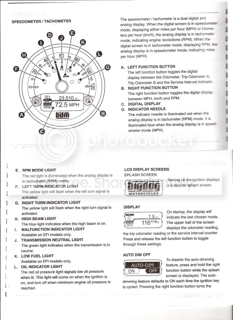

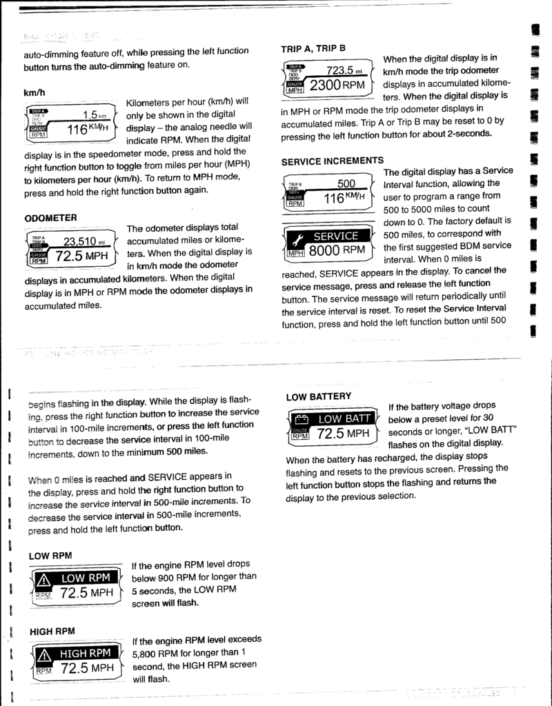

p.s. I didn't get any sort of manual on what this does (how the buttons work).
Since this is basically what the Wolf had, if a Wolf owner can upload the functions, it would really be nice.

5 a service mode (not sure what this does)
The "Service Mode" is just a count-down in miles until your next desired service interval. My initial countdown was for 500 miles (first service), then you can set the next amount manually to countdown. I just set mine to 2500. Hope that helps.
I can post some instructions from my owners manual later tonight if I get a chance. Shows exactly how to do it if you still need them.

Maxim_es
These scans turned out pretty shitty, but hopefully readable if you need them.

Thanks for scanning and posting how it works.
