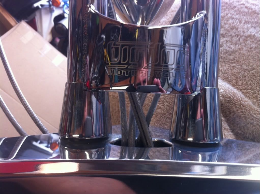

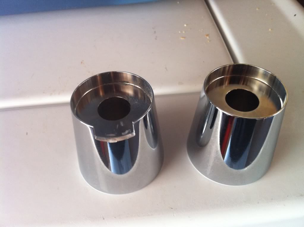

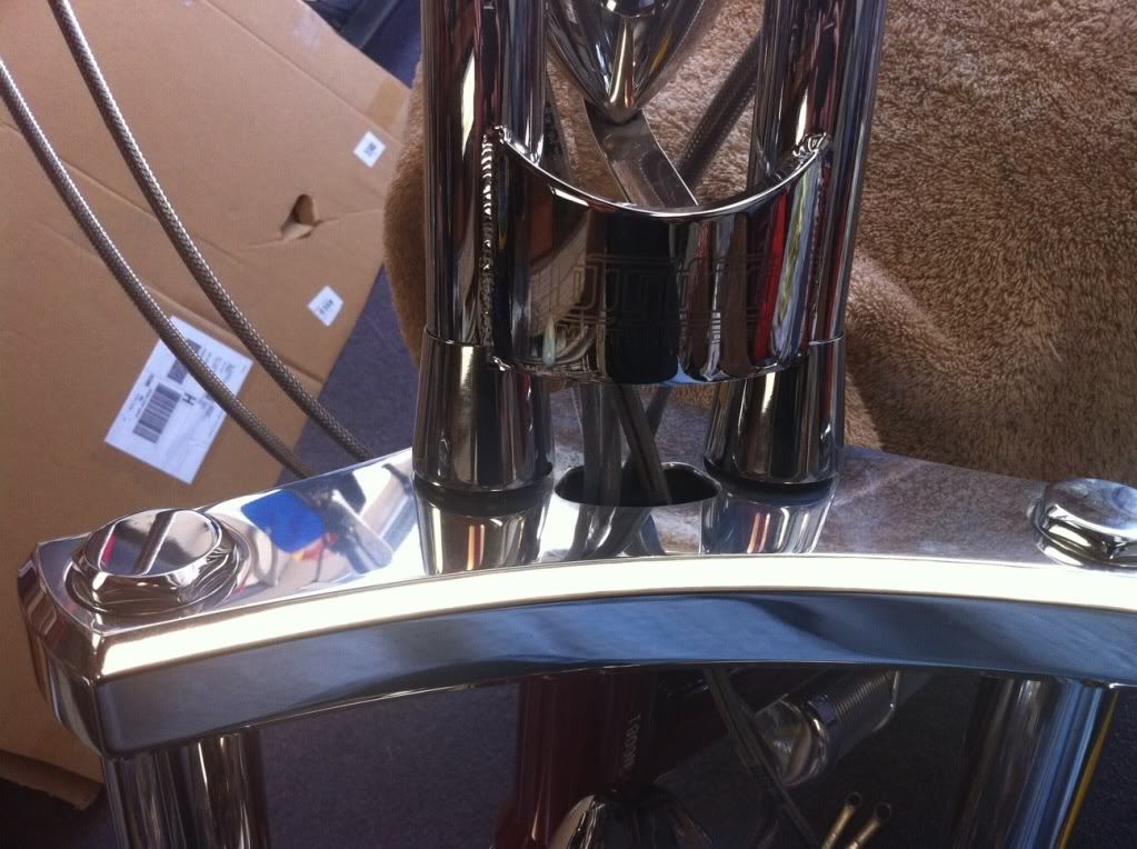

Got the 1.5" risers installed today - big difference, love the additional pull back & feel. Honestly, they could be a little longer for me but it was worth it, happy with the install. I also had to notch (dremel) the aluminum risers to make room for the 3/8" Big Dog plate thing between the bars - no big deal, the cables all reach fine and you'll need 4" grade 5 or better bolts. Photos for reference.
