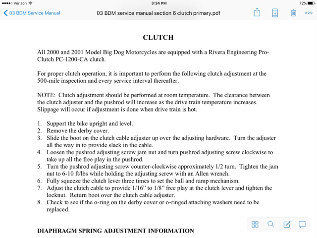

Are you talking about adjusting the clutch cable itself?? My cable is adjusted out so far that the bottom part is not on threads, I have the back nut tightend down to keep pressure. Is it possible I just need a new clutch cable. Thank you for the quick response
TapioK
This may help you.
Tapio
mittens
I am talking about pulling the clutch cover, (large round removable cover on the primary) and adjusting the clutch adjustment screw.
normally a 11/16” nut in the center of the clutch housing, and an Allen key screw in the middle. you hold screw still, loosen outer nut, and then adjust ever so slightly to get more disengagement.. then lock back down and test drive it around a little.
SMALL adjustments is key here. 1/8th of a turn can make all the difference between awesome and slipping, or dragging
