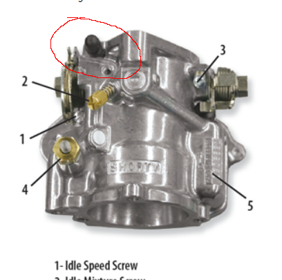

hey guys, can someone identify this rubber cap on the top of the super g carb? it doesnt appear top be on the super e/g expanded parts list and mine is cracking. thanks

When you put the new cap on, put a small zip tie around it. In case it back fires through the carb, it won't pop off.

VS. $5 and it's today, but tomorrow you ride as you wait for the glue to setup. 1/3rd the price is 'goop glue'. Pit bike kept on stalling. I make sure I pack the glue for any kind of repair. Cracked vac cap was sucking air. I just fingered some on as the fast fix, because pit is also for pisstops and the bike is used a lot.
I'd leave it on, finger the glue around it. It sets up kind of, sort of fast, then fill over that in a few hours. Amazing [Goop Glue] how it resists heat, oil. And no, I am not paid to push the product. I just field fix the fuck outta that tube.

Amazing goop is bad ass i will agree...i use the seal-all one which amazing goop makes...good stuff forsure
