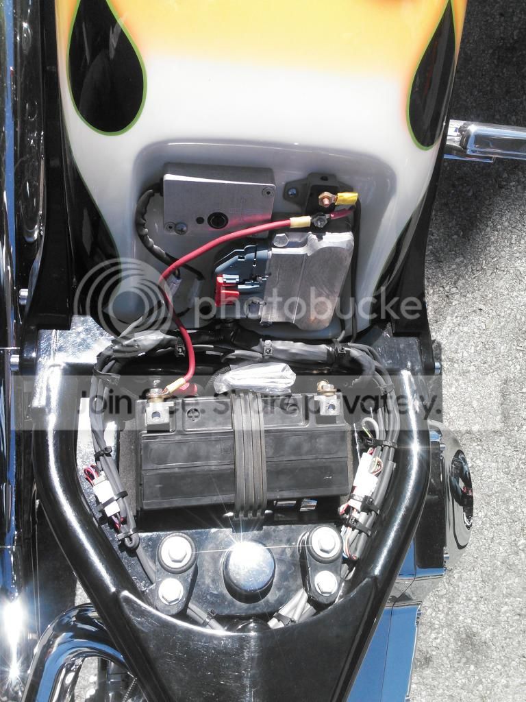

Hey guys. Well I installed the RIP kit the weekend before last. The kit is truly a plug n play system. I started by pulling seat and tank off, removed battery, side covers and then the ehc. I pulled all connectors under the tank loose and was able to fish out the factory front harness, then removed the rear harness. The rear harness was very minimal and very little to do. Once all factory harnesses were removed I ended up using a coat hanger to feed down the backbone to the insert point. I ended up taping half of the harness into one bundle then the same with the other half. It was a little bit of a chore to get them fed through, but took my time and walked away for another beer once it pissed me off. Once I got the harness through I let it sit and moved to mount the module, mine wouldn't work as they designed it to be because I had made a new seat. So I ended up pulling the battery box and modified it so I could mount the module on the bottom side below the factory ehc location. Once I had that in place I ran the back/lower section of wiring to their dedicated spots. Then connected all the upper harness JST connectors at backbone, when I did I had a little bit of a hard time getting all the harness close enough for the tank to fit, just had to get it all laid as close to the backbone as I could and spread out so there was nothing bunching up in one spot. But I got it situated and reassembled everything. I started bike and rode a few miles and came back to recheck everything.
I didn't have left rear lights or a speedo. So I started checking my light issue and found I had no ground. So I started chasing down my ground for the left rear lamps and the ground was actually ran to the speedo ground. I cut the ground wire and contacted Jason to make sure I was correct and he confirmed that was my issue. So I connected the two grounds to the main harness grounds and retested everything. All worked perfectly.
The only thing I would like to see is a pin location for the wiring at the module so if I ever have a short or wire issue I know where to go, and during install there are two red wires that run together with one eyelet that is labeled (CB) and took me a bit to figure out it went to the circuit breaker. But that could of been my stupidity also.
I rode all week with the kit on and probably 400 miles or so. So far everything is working perfectly fine, I have no complaints on the system once I got the ground issue lined out. As far as 12mo/12k miles from now, heat, rain, etc... Like was posted previously, If I have any issues then you guys will all know and hear straight from me what they are.
