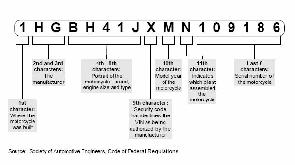

First letter is a K? No clue what that is bro. K is not a valid VIN. Hopefully you don't have issues at the DMV. Looks like someone tried to put that on themselves not a straight letters and manufacturers stamp them so letters can't be out of line. 7 character is a big question mark for me?
Wish you luck man!
Any big dog would have a 1,2, 4 or 5
The 10th digit is the year and an L indicates 1990
The 1st character in a car's vehicle identification number indicates the country in which it was manufactured.
Some of the country codes include:
1, 4, 5: United States
2: Canada
3A-37: Mexico
J: Japan
VF-VR: France
9: Brazil
WA-W0: West Germany
S: Great Britian
