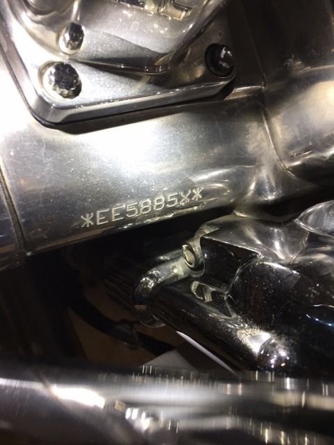

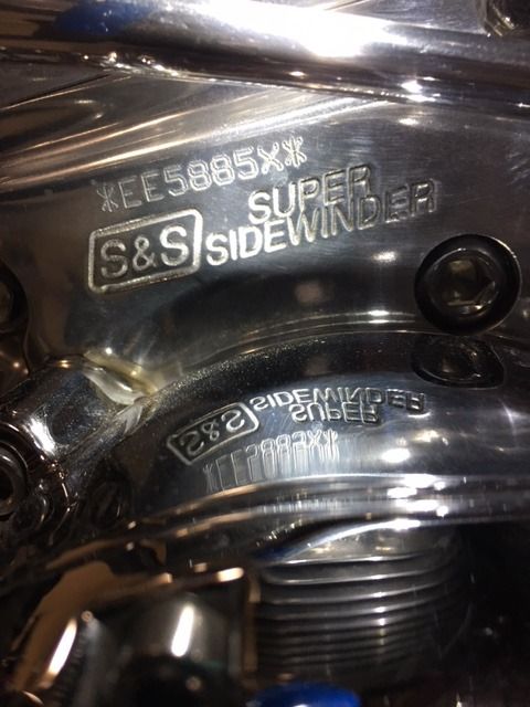

OK you BDM knowledgeable detectives! Here's what I've found. The title numbers match the neck and sticker numbers. The title says 2005 BDM Chopper with 1930cc motor which is about 117 ci. Sticker on down tube also says 9/04. The following are the pictures of all of the identification numbers I can find on the engine. Can someone decipher them? Thanks!
Thanks! I believe I read where there was some grey areas between the introduction of the 117 in late 2004 early 2005 models. Anyways, if you could decipher all of the markings it would help me understand the bike better. Thanks!
PS Ordered the Alex EHC replacement and new plugs. Should be here in a day or two and I'll reassemble and see how it goes. Thanks again!

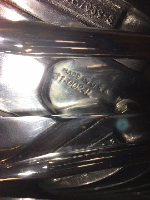

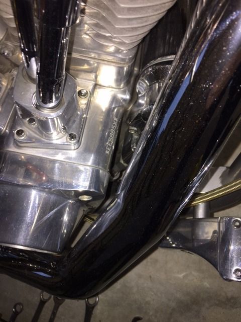

There is some grey area....yep. looks like you might have an old stock bottom end and they put the 117 cylinders and heads on it.
I dont know how to read the numbers...but for what it's worth the first letter E on the engine matches my 04 and my 07 has a G which makes sense it was bought in 06. take a pic of the bottom right side near the oil filter. This will tell you if it's crank or cam. Only one has to be working haha.

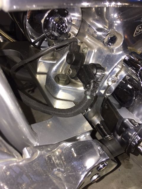

This is a pic of the Cam sensor plug on the left.

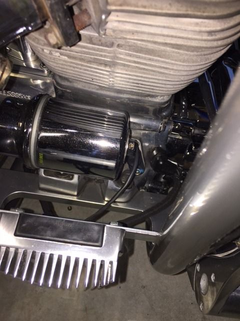

Here's what I have. Looks like 104 crankcase and 117 top end. Could very well be original with 4.000 miles on the bike and a build date of 9/04. Any way to get the original build sheets from BDM with your vin #? Thanks!

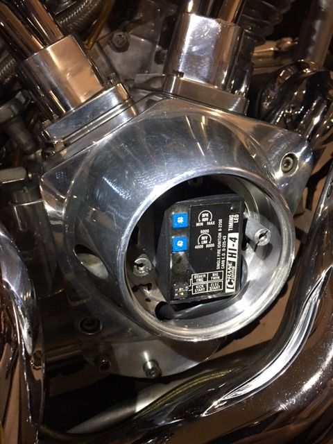

Haha well dang it you got the crank sensor and the cam sensor plugged in. Only one of them has to be working. You are going to have to figure out which one is working.
The ignition module has a red light on it when the run button is pressed and blinks when starting. Will be solid red when bike is running.
I'd check the light, and trace the wires. And remove which ever one you are not using.
Whoever put both those in was very lazy and never removed the old stuff.
Quite frankly the crank sensor and ignition module would be ideal to run. The Cam sensor is old school and not as easy to tune. I'd run the crank sensor If I were you. Raywood also just converted his to a crank sensor and said it started quicker.
You got a polished bottom end, so yep I believe it's an 05. I wouldn't worry about it. If you want buy that Cam cover from that eBay add, chuck the crane ignition in the rubbish and get the crank sensor working. Then it will look like it should!
