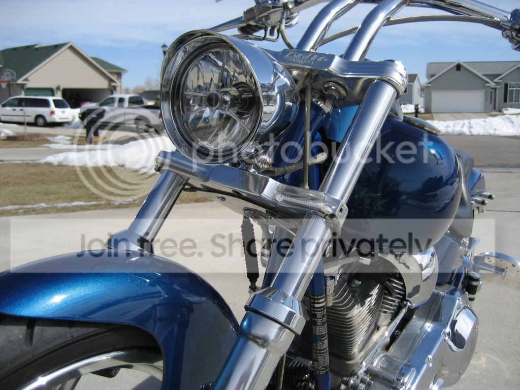

I just installed the same type on my husky.....very cool. They are extremely bright. i bought mine from Radiantz, which I'm sure is who supplies this company with them. They are flexible and you can cut them every .6 inch.
i just heated them up with a hair dryer to make them extra pliable. They are just hold on with 3m double sided tape. i got the idea from.....Dog1. And he said they work great and hasn't had any problem with the lights coming loose. i had radiantz cut the rear ones in half so directly in the center is where my left and right are set. Very easy to wire them in.
I also installed them on the front, put them on the lower tree.
But as stated, these are not DOT approved. If you have to bring your bike through an inspection.........chances are they will not pass. I'm taking my chances on the road becuase there is no inspection needed in ND.
