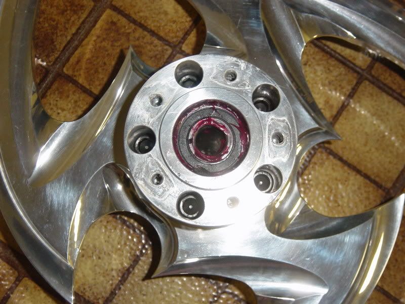

Raywood, any trouble getting the seal back into the bearing after packing more grease into the new ones?
No, they pop right off very easily. I posted pictures on my front wheel thread where I pulled the seals on two bearings and one had grease in it and the other was practilly dry.
So I filled them up. I've now been through 4 bearing changes and have not had an issue wiith heat build up. If it expands it would just leaks out cause the seals are no sealed as you would think it means.
I just got 3 more to change out the rears as I've done a lot of miles this year and have over 10,000 miles on the current set alone. I'll post pics of the old ones when I get them out and see if they still have the grease in them.
As many bearings as I go through I'll just keep using these ones rather than spend $75 for three bearings just for the rear!
As Ray said... they aren't so much sealed as covered.
Pop off the dirt cover like below
Then the "seal" and find it like this
I added some mobil 1 grease to mine...
Once you pop the seal back in... it gets ride of the excess
