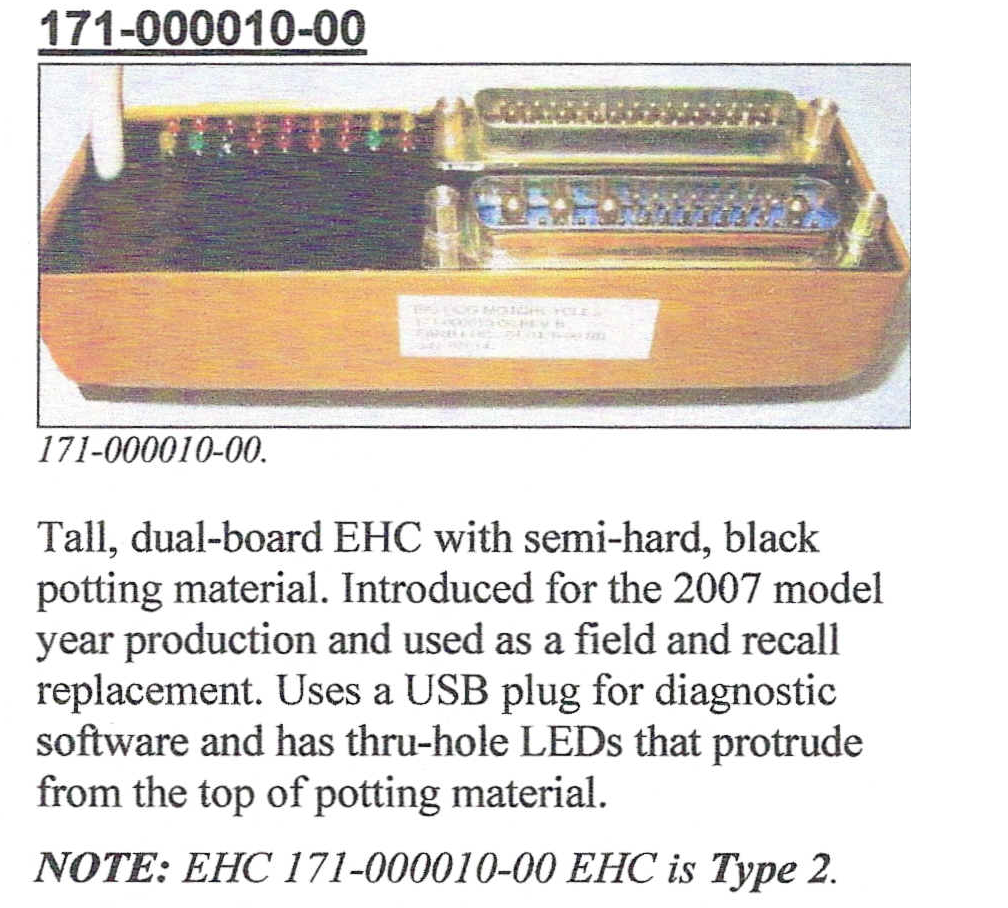

You mention something about the ehc having a problem. My question is is there anyway I can check to see if the ehc has been upgraded already? If not what do you think my bast option is? Is there a replacement that doesn`t have the problems the stock ehc seems to of had? It is always something with this bike,but,I still love it.
